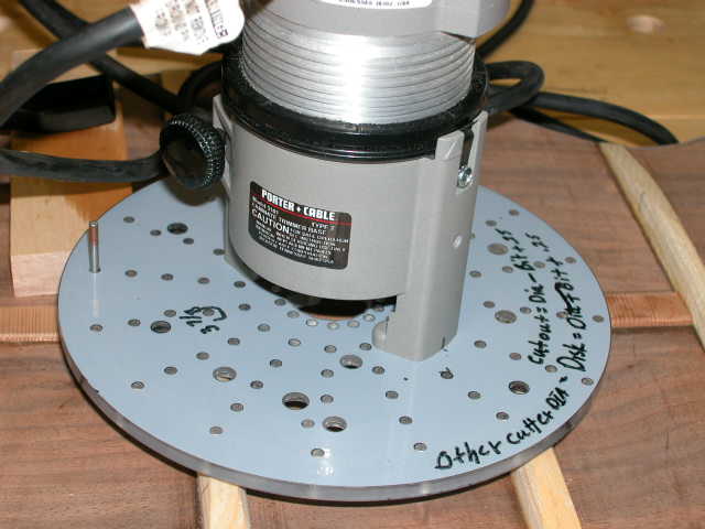

While I was at it I took pictures of my shop/area/tools thinking about the post on what one "needs". I could post them if anyone is interested but you, as my friends, would probably book me into a program. SORRY ABOUT THE SIZE AND LAYOUT-NOT GOOD AT THIS-PLEASE LANCE,FORGIVE ME?

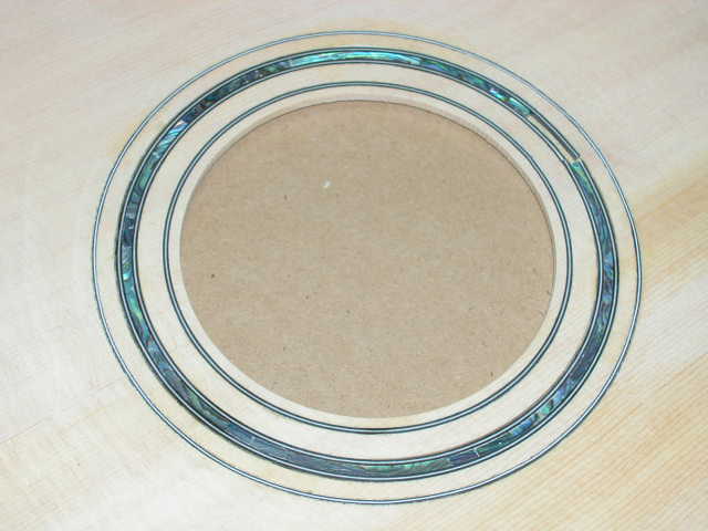

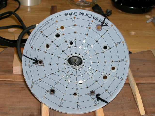

Explanation- first picture shows base with pivot pin -I just store it there-that would be around a 7" circle or disc.I wrote the alternate cutter formulas on it so it was always handy. Second is bottom view, of course. The screwhead with the little black dot by it is the added screw hole. The big arrows are for the supposedly universal mounting holes for routers-I think is is a 2 9/16 radius-I made some router tables for friends and used it with my Bosch 1618 VSS.And, of course, the others are my very first rosette and soundhole-somewhere I wrote down which bits and which settings for the pin-oh yes,on my workboard with the steel interchangeable center bushings. Now, isn't that idiot proof?*I can't tell what is going on here-i'm using the format. Miketobey38780.6002893519
