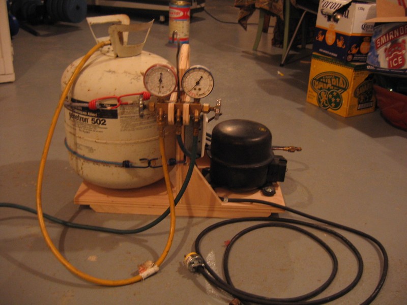

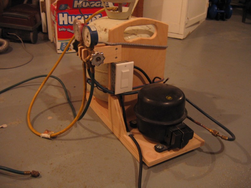

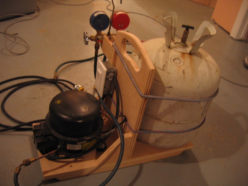

Here is a picture of the system that I built after talking to Dan and then getting my buddy who is a refridgeration dude to help me out with the parts and the putting it together. I don't have any inline filters, probably a good idea although there are lots of these compressors around and it is pretty easy to replace them. As Dan said the tank is a vacuum reservoir. You suck it into vacuum and then when you open the valve and turn on the pump you have that vacuumed tank to get you started. It takes only a couple of minutes to empty the tank with this pump. It is so quiet I am considering a light that goes on with the power so that I don't leave it running on accident.
Hope this helps!

That's a 'wild setup'! Are you using it with a vacuum bridge clamp, a brace clamping press, or both? If with a vacuum bridge clamp, did you make your own, or buy one from LMI? If you made your own, could you post some pictures, and a description?

Hi Chris, I have an LMI Bridge Clamp that I bought from one of our OLF members. That is waht I built this unit for. But I think that with the reservoir tank it would work for braces also. But the go-bar deck is so quick and easy that I don't know that I would get to building a brace press for some time. Dan Minard (DanielM) has built all of his presses and is really the guy to talk to about that. This set up does work very well.
