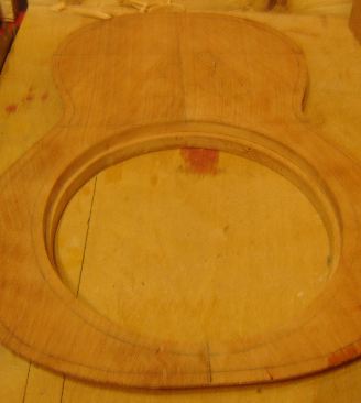

Not much to post, but I'd love to generate a little more traffic on the resonator side.
Pictured is the top to a concert ukulele resonator protoype. It's built around a National cone. Woods will all be curly cherry, perhaps with a curly maple binding and a walnut purfling.

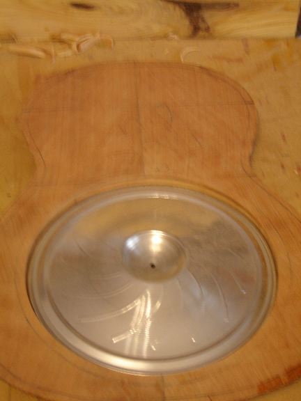

I dropped the cone in and re-shot this morning.
This is the same cone that Elderly stocks. I picked it up directly from National before Elderly stocked it. National will sell most parts. I think I paid about $50 for it.
Eventually I'd like to experiment with spinning cones and making faceplates.

Something will come of it. I'm waiting for a National faceplate before I go on. I need a better idea of how high the bridge will be above the "soundboard" to determine fretboard thickness, neck angle, etc.
As a uke builder trained by a classical guitar luthier I've never built anything but Spanish heels. This may be the first resonator with a Spanish heel or I'm going to be picking up some new skills soon.hoosierukes38789.7877430556
