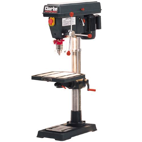

Laurent I think Wagner are talking about a perfect world which I think we can all agree doesn't usually exist. The most important thing to think about is the distance from the drill head to the column so that reasonable pieces of wood can be planed. something like 8-9" should be OK. The spindle speed on my press goes up to about 4200rpm but I usually run my Wagner a 3700rpm as I find that I get the best compromise of speed and smoothness I have tried it at 3000rpm and it's just fine even at 1500rpm it works but needs a finish with the ROS. In the UK there are a number of reasonably priced large presses available. Mine a Clarke 401B was bought on a tax free day at my local store for ?157 ($270). Every time I look at it wonder how on earth they made it for the money never mind sold it to me for that and still made a profit.
Just look for something with the wide throat and 12-16 gears, they usually have the higher speeds.

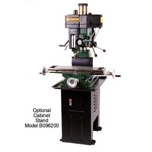

Now that's what I want! 1200$ It's a milling/drilling machine. I was at BusyBee Tools yesterday. Standing in front of this baby I was thinking about routing saddle slots, truss rod channels and whatnot...
