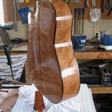

I just love the stuff. Extremely forgiving. You can have a few 'sessions' on there, sand back to the wood (if you spot a ROS swirl mark ) and have the baby back to spit shine condition in ten minutes flat.
   I was a bit aprehensive before trying FP. Reading on the difficulties and time required to apply a good finish. But after just a few 'sessions' I'm sold big time. The secret is not to load with too much shellac/alcohol. Once you get the mix right, you're laughing.
   Here's a picture after my third 'session'. I had let it gaz out so that's why you see some of the oil permeating to the surface.

Right on the mark Alain!
Not only can you fix swirls and be back in business...an entire finish can be applied and be ready to be handled within a day.
The amount of mix and oil on the rubber is, indeed, the secret.
