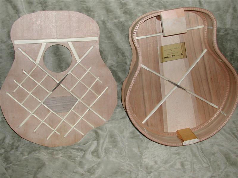

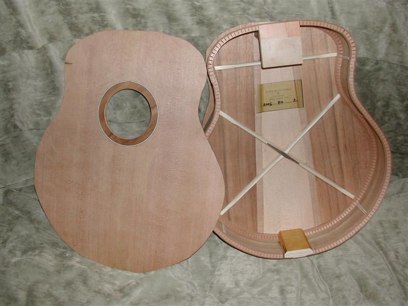

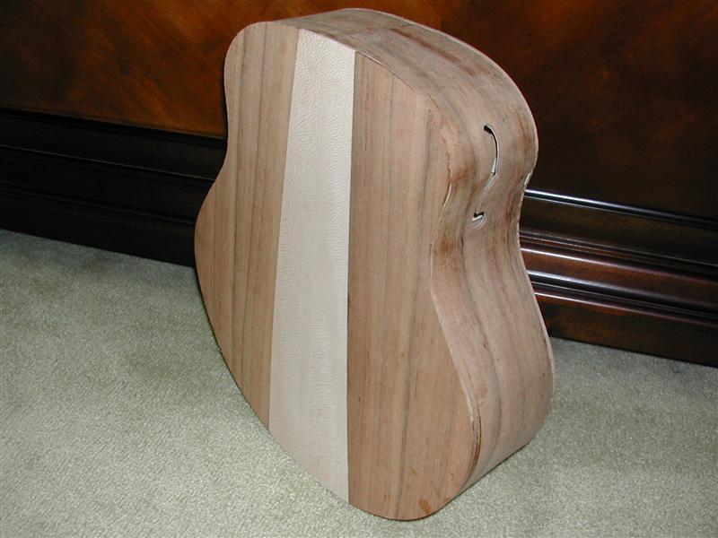

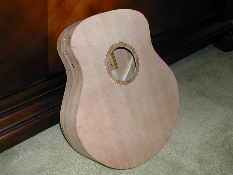

Well, I had a very productive week. Got the top braced and voiced and glued on. Flush trimmed the body, and now its time for the binding. I'm hoping to finish by mid-May. Enjoy!

Cool!!! Love the look of lattice bracing.

Looking good. Interesting bracing - you could have a game of chess on the top while you close up the box
I like X braced backs on these instruments, I really think it helps the projection.

I really like your top bracing Tracy!
What kind of wood is the top again?

It's Cedar. Mark, thanks about the lattice bracing. I'm just following Graham McDonalds suggestion. I have no idea how to voice a bouzouki top, so I followed his suggestion to get it in the F# range before gluing on the sides. After it is bound and the top edge thinned, it should ring at about C#. Right now it is at a D#, so I have a ways to go to bring it down. I just hope thinning the edge down .5mm around the lower bout will take it down enough. I'll keep you all updated. Thanks for looking!
