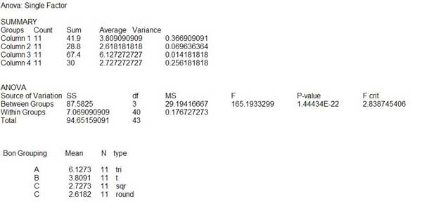

Well, I've been thinking about testing some bracing shapes for awhile and finally got around to it this weekend. I wanted to test four different profiles. My wife has the digital camera out of town right now, so here is a pic from David Schramm's website:
The four I tested were the square shape, triangular shape, the T-brace, and a standard rounded over brace not pictured here. I cut and shaped 11 braces from the same piece of spruce stock. I used a simple deflection test of every brace to gather my data and measured results in 1/10th mm increments. I was really expecting the T-brace to be the strongest based on info from John Gilbert on the Schramm website. Once I had all the data, I used the SAS statistical analysis program and ran a one-way ANOVA to look for differences between the groups. I know this data is probably a bunch of gobbly-goop to most, but I'm including the data for those interested because I know there are more than a few here familiar with the stats listed.
So what are the results in plain English--read on:
The T-brace and triangular brace were both statistically significant as far as being different from the others. The Triangular brace showed significantly more deflection than the other three. The T-brace showed significantly more deflection than the other two (round/square). There was no significant difference between the rounded and square brace. What does significant mean? In this case, according to the p-value listed in the ANOVA, these results would only occur by chance in less than 1 in 10,000 tries. I computed the actual p-value and to be more precise, these results would occur by chance in 1 and 1 (with 22 zeros after it) times. While testing, I should note that I broke 3 of the triangular shaped braces during deflection, so I had to test 14 to actually get a sample size of 11. This test confirms the fact that the rounded over braces many of us use seem to be the best for strength. While the rounded brace was not significantly different from the square, it was significantly lighter, lending credence to that as being the best profile to use out of the braces I tested. I plan on trying to duplicate this test using cedar bracewood, as well as another group of spruce with a much larger sample size (from many different pieces of brace stock). This was just a quick, down and dirty test to see if there would be significant differences, and there were.
Cheers!

Your results are interesting.    You said your expectations were that the T shape would be stronger that it tested. Maybe it depends on the height of the base (top of the T). It could be that an I-beam shape would be stronger. The I-beam shape could even be drilled out for a lower weight. Thanks for the information.

Two ways to do this, either change your response variable to the ratio of deflection to mass (defl/mass) or include the mass of each brace as a covariate in your analysis.   This way the sums of squares attributable to variation in mass will be removed from experimental error and the F-test for brace shape will be correct.
Instead of F-tests and P-values, consider reporting means of the response for each brace type with its 95% confidence interval; where those intervals overlap amon brace types, you can conclude no difference is the response (at alpha = 0.05). If the intervals don't overlap each other, you can conclude they differ at the same alpha.

I did do as you both mentioned above. The glue surface width was the exact same on every piece, and I did weigh all the braces. The braces weighed the following in grams, averaged:
T-brace - 7.5
trianglular - 5.3
rounded - 7.2
square - 9.0
Mario -- you gotta take everything a step at a time. You can't just plug everything in a single equation to get the answer--you could, but you'd give up a bunch of variance and increase your odds of type I and II errors (showing sig. results when there aren't any, or not showing sig. results when there are some). This was just the first step I posted for those interested. There's plenty more to be done.
Bob - That's a good idea about reporting confidence intervals. I didn't think of that. There's all kinds of good things you can do with the data.

Your triangular isn't a true triangular shape; if it was it would be exactly half the weight of the rectangle....
Gotta be anal if you wanna trust the results <g>
You can, and should, gather all this info at the same time. Each brace should be weighed, then measured for deflection, at the same time. Then it's math, and the answer.

[QUOTE=Mario] Your triangular isn't a true triangular shape; if it was it would be exactly half the weight of the rectangle....
The triangular shape is the 2nd one from the right in the pic. It's the one with the flat top, not a true triangle. Also, I am very accurate with my measurements and did take them all at the same time. I just didn't run all the stats analysis yet. Programming the code in SAS isn't nearly as fun as making sawdust!

By measuring deflection, John is measuring the stiffness of these beams, not the strength. Stiffness is defined as load divided by deflection, so it would be easy to calculate the stiffnesses of these beams using his test data.
Strength is a different beast, entirely. Strength is a measure of how much load each beam can support before it fails. We could further define "fails" as being either total fracture, or failing to return to it's original shape when the load is removed.
It seems to me that, to evaluate them for use as guitar bracing, there are three important properties for each shape of brace : stiffness, strength, and weight.
Now, the REALLY tricky part is understanding what value for each of these is best in a guitar. I think everyone would agree that more strength is always better, and most would agree that less weight is generally better, right? But, there is probably a "best" stiffness, that, like Mama Bear, is just right. And, it probably depends on the style of music you want to play and the sound you are looking for.
Back to the tests:
The stiffness of the beams, by themselves, can be reliably predicted using strength of materials, if you assume that all the material (each fiber in each beam) behaves the same way. And, if you assume that the shear effects are small; this is generally true for what engineers call "slender" beams - maybe 10 time (or more) longer than their height. This means that the "sliding" of the fibers relative to one another is not important, and that the major effect is compression and stretching of the material at the top and bottom of the beam as it's loaded.
In that case, if you hold the maximum height and width the same for all of the beam types, the rectangular section will be the stiffest. (pretty obvious, since all the other sections fit within it's outline, and, consist of the rectangle with some material removed). The traditional rounded-top section will be less stiff than the rectangle, and also, less efficient, in terms of stiffness per weight, than the rectangle.
I know that John's testing hasn't shown that - I don't understand why that is. It would help to know the actual dimensions of each shape.
The most efficient shape in terms of stiffness vs weight (for a beam alone) is an I-beam. That's why I-beams are used so often in structures.
Another way to increase stiffness is just to increase beam height. A tall, thin beam will be much stiffer (and, stronger, also) But, there might be other problems. If it's too tall and thin, it may buckle under load, or be too fragile to direct loads on the side of the beam. Also, since it would be stiffer, it would be more vulnerable to impact loads. And, for a guitar brace, the glue surface might become too small. ( It's possible that the current typical brace height is a carry-over from the time when glues were not as good.)
But, what's really important in a guitar (as someone posted) is how the beam/plate combination - whether the plate is the top or back - acts. Understanding the brace by itself is the logical starting place.
When you couple these beams to a plate (top or back of a guitar, for example) it gets a lot more complicated.
The beam and plate act together - you get much more stiffness from the combination than from either part by itself. Now, to get the most stiffness per weight (at least theoretically) you want the beam to be a "T" shape, with the top of the "T" away from the plate. Now, you have something that looks a bit like an I-beam with the plate acting as the bottom of the I-beam. And, the stiffness ( and strength) of the glue joint becomes important.
