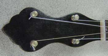

I've dyed shellac black to retore an ebonized banjo. It worked well. Use alcohol Soluble aniline dye. I'm not sure how colorfast these dyes are. I've heard that they fade..but should be okay for a cased instrument.
