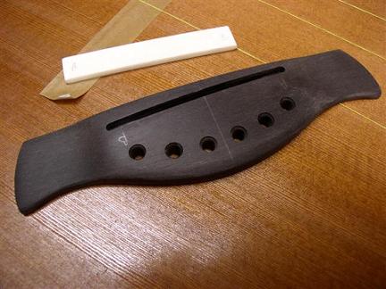

man hows that saying go, right tool for the right job. I know most of you know this, bit how good it feels to have a razor sharp bit when cutting a saddle slot. Just today I got a new 1/8" bit from LMI, that thing cut through Ebony like a hot knife through butter! Im using my John How saddle slot jig, and a PC lam trimmer. So fun when things go right! Nothing much more to add.LanceK38359.9241435185

number? Hey Lance, this is a fine looking bridge, one more evidence a master luthing job is happening, handmade bridges. Congratulations, I'm not far behind you on this. I like the cool ramp on the ends so smooth from the lower wing to the main body of the bridge. Go Lance

CA4 End mill, 1/8, 1/4 shank, carbide     $21.45 From LMI, RAZOR Sharp! THe first bridge I cut in 3 passes, the second, ONE pass, that blade is a hot knife, well you get it! Thanks Bruce on the bridge comments, John How set me up with a SWEET bridge making jig, just like the one in the Jigs section, I can make a bridge in about 1 hour. The second part is the tapering of the wings, I do that using my Luthers Friend Jig, if you've not taken a look at that jig, go here LUTHIERS FRIEND LINK
There are so many uses for this jig, I can t list them all, I'M still learning what it can do, If your interested give Ken a call, he a real good guy, at the very least, check out the robosander, which can be purchased separately.LanceK38360.2947569444

Paul, I used a 1/8" shank in a dremel, that thing was all over the place! With the 1/4" shank, I was able to change depth and cut again, over and over in the same slot and it ever wavered. My slot it dead perfect side to side. And the ends have a nice smooth radius.

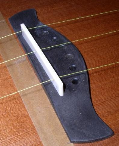

P.S. That is a nice bridge design. I like your alignment system...simple and efficent!
PostPosted: Sat Jan 08, 2005 5:13 am
Posts: 8556
Yes, Kevin Ko taught me that years ago, draw a straight line down the center of the fretboad, headstock to 20th fret, then a piece if thread taped at each end, dead on center reveals any skew in the neck set, (Ahem!) Cough! I have a little skew
