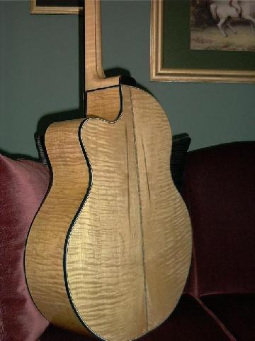

Here is my question: Is this mahogany genuine Honduran mahogany or is it African mahogany or Khaya? My guys at the wood place today only had the African, and frankly it was very streaked with dark grains, not homogenous like the wood above. I don't need any learning experiences but it's time to stock up for the next dozen necks and it's gotta be right. TIA bd

Bruce, Most African Mahogany that I have seen has been pretty streaky or in figure I guess you call it ribbon. I'd say what you have in the pic is Honduran or something real close.

Bruce that looks like honduran to me. Mattia that african neck looks very good too. There are other alternatives woods. I have used maple, cherry, butternut and walnut and all make great necks.

It definitely looks like plantation grown honduras. How is the weight & density?

Bruce---fine looking guitar, by the way. And from here in East Texas, the neck does indeed look like "Honduran" mahogany. Go get some more!
