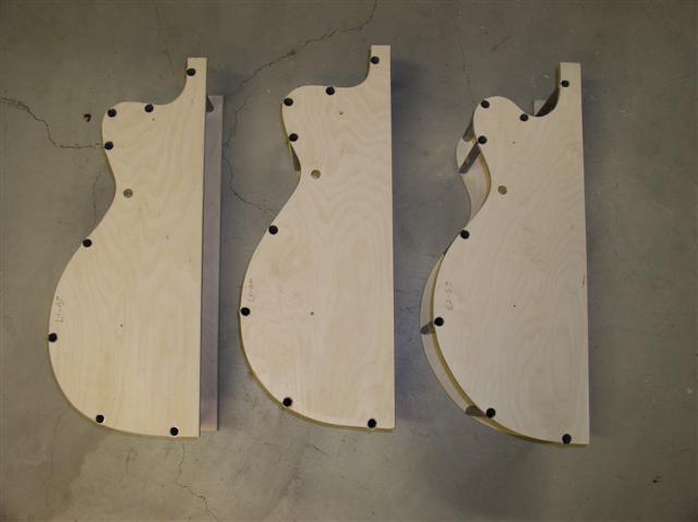

Thought id share my new bending forms.
John Hall (Blues Creek Guitars) made up this
cutaway forms for me.
Cant wait to use them
The Models are left to right
L1 (cross between a large parlor and an L-00)
OM (well -- its an Om)
And my E2 which is Sj sized.

Are you having success bending the cutaways on your bender? Mine has been mixed. I have switched to bending the upper bout and cutaway by hand.

I'd also be interested in knowing whether you can bend the tight cutaway on your E2 model in the Fox Bender. I'm building a GC sized cutaway with a fairly tight radius (Ziricote @ .080) and haven't used the bender on this tight of a radius before. Thanks.

Ill keep ya posted. it will be my first.

Hey, guys, this is one of the flaws with the Fox bender. I've had limited success hitting them all the way on the bender. But I use a compound cutaway that needs to be done on a pipe anyway.
Jimmy, I would suggest bending it slightly on the bender then taking it to the pipe. Zircote is not one of the woods you want to be experimenting with on a bender. Very brittle.
I'm in the process of redesigning the cutaway tower that will be something like the waist tower in that it has a reinforcemet bar that supports the wood. The problem is that there are two major bends going on at the same time and if you support one, the other will most likely snap. Still thinking on this one. Paul

Jimmy, you might want to consider--if you are doing a venetian cutaway--further thinning the Ziricote in the area of the bend. (And only in that area.) Perhaps down to 1/16" or so. Then reinforce that on the inside with a matching veneer, which can be terminated at a side brace. Does that make sense?

Ziricote scare the heck out of me. I've done two of these guitars, and I've always experienced some slight fracturing when bending the sides. Fortunately, super glue makes for a great repair of it. I'd be terrified of thinning it that far, but if you have a spare set of sides, it might be worth a try.

[QUOTE=Don W] Ziricote scare the heck out of me. I've done two of these guitars, and I've always experienced some slight fracturing when bending the sides. Fortunately, super glue makes for a great repair of it. I'd be terrified of thinning it that far, but if you have a spare set of sides, it might be worth a try.[/QUOTE]
They would actually be less likely to crack at that thickness. They might be a little too flexable for your taste, but if you then laminated the inside of that small cutaway section with matching veneer it would be very strong and the least crack prone part of the entire guitar. I used this technique on a very curly set of mahogany that was just looking for an excuse to pop a curl. Worked like a charm.
