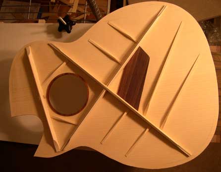

This is partially braced before I carve it on monday, here's the rosette:

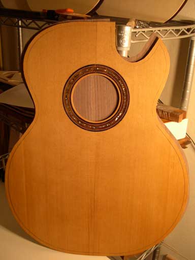

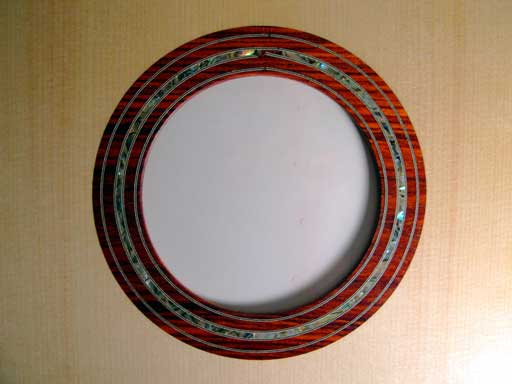

BD (that old devil) sold me a set of plans for an Olson SJ, so I made some molds, got some cedar and walnut from AC Woods and here's the top ready for bracing to start:

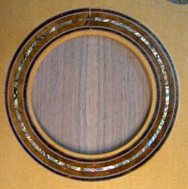

Here's the rosette:
That's rosewood on outer ring, walnut burl on the innner and paua in the center. I hate working with cedar though, I dropped a tool and had to steam out the dent

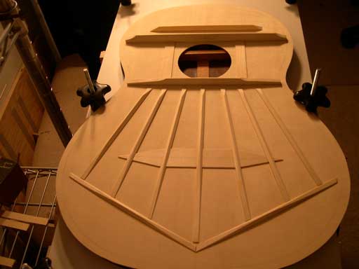

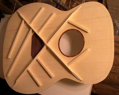

Also someone asked me to keep and update on the snakehead fanned fret, here's the top all braced:
The bridge will sit across the upper X brace and then the bass side will float out over the patch, this should give it good bass response (that last one was killer) and I made the patch bigger this time to keep the bellying to a minimum.

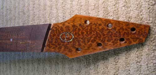

Here's the headstock, it's all snakewood for this one:

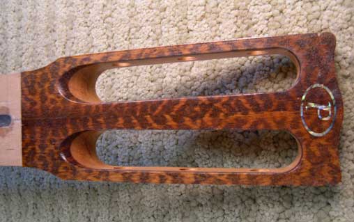

Finally I'm working on a new classical that's based on a hauser....
The top is engleman, it's got a snakewood headstock on it, will have a snakewood fingerboard and brigde and should be ready for healdsburg this year.

What is the eventual stringlength of that bass E string on the variable length strings?

No getting bored at your shop, is there? Nice looking work. Is that a cabon fiber rod in the classical neck?

27" for the bass and 24.75 for the treble, I dread doing them because it's an odd sliding scale and they take lots of fussing when placing the bridge. I have *another* customer now asking for one so this time I'm making a set alignment jigs so I don't have to sweat that anymore...

[QUOTE=Steve Kinnaird] No getting bored at your shop, is there? Nice looking work. Is that a cabon fiber rod in the classical neck?[/QUOTE]
Never bored that's for sure!!
But it does get hectic, I'm learning to do them in little batches, so while the hide glue was drying on the zircote I carved on the snakehead and when that was done I worked on the classical for a bit...
And no it's not a CF rod,, it's just a buried truss rod, I don't think classicals have enough pull to warrant a CF rod (in my opinion)..
