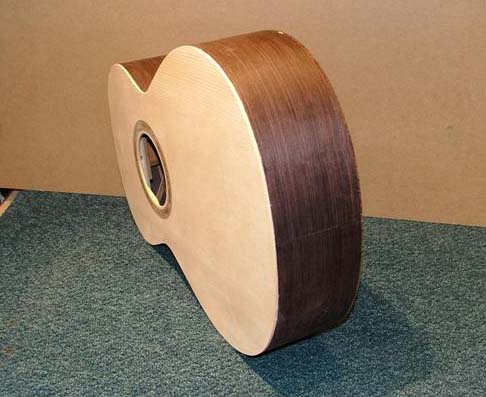

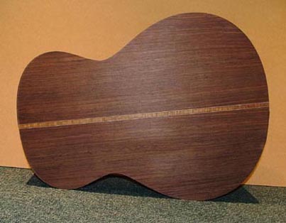

Well folks, the OLF guitar back is now glued on. I discovered there truly is a good use for rubber cement in luthery. Unfortunately, I was very tired when I did the work, and consequently I glued the upper bout to the lower bout. At least the center line was perfectly aligned! Not being sure what to do, I simply trimmed the lower bout of the back to fit the upper bout of the rim. That left me with two really great sound ports at the outer parts of the lower bout. Wow! Mistakes can make for great ideas! ! ! ! ! I reinforced the edges of the new ports with some of that great table-top epoxy coating stuff. Now the port edges are good and strong, even though they're now about 1/4" thick.
Pics to follow.....
And the other good news is that the OLF Guitar is making it's way to Chatham Massachusetts tomorrow to have Matt Gage glue on the top. I'm excited to see what he's done. We're a bit concerned because the drawing I sent him to make the top was at 3/4 scale. Hopefully he left the top trimming a bit large. So long as that's the case we shouldn't have too many issues getting it glued on to the rim.

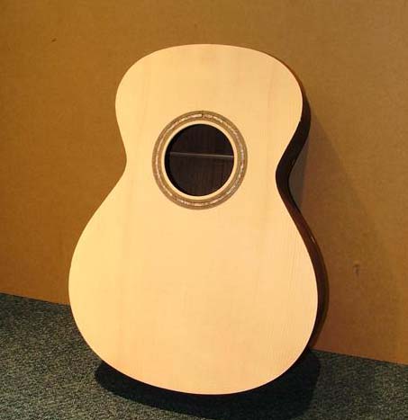

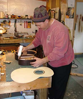

Mission Accomplished ! ! ! !
Matt Gluing top:
More pics to follow!

Hey! cool! Dang Matt, did ya hafta take out a second mortage for all then Quick grip clamps!
Looks great guys!

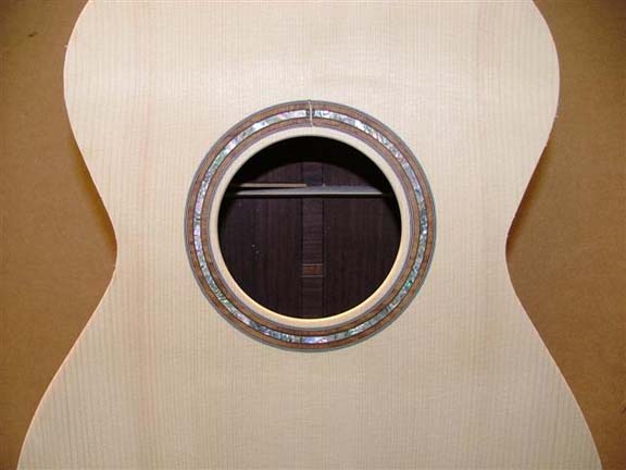

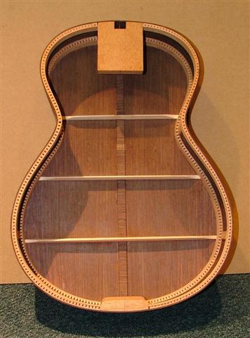

Ahhhhh....the neck joint...
Yes, there are some interesting things going on there.
The mortise is actually slightly wider than the the typical 3/4", and it's also shallower than I'm used to seeing. There's also no slot cut in it for the truss rod, and no bolt-on holes drilled as yet. Matt and I were perplexed at how all that is going to come together, but figured someone out there had plans to deal with it.
One WARNING to whoever gets this thing next. (Paul W.??)
There is no stop to the neck tenon mortise, so you're going to have to be very careful when cutting the binding channel, lest a router bit sinks its way into the mortise pocket and right down through the back.
I was tempted to put a mahogany stop block in there, but didn't know if I would mess up someone's design.
Please let us all know what the plan for this is, and the design elements of this unique neckblock!
More pics of the box tomorrow!

I think it would be a very good idea to glue a small stop block in that area to ward off such disasters. Make it about 3/8 inch deep,(or thick) and that will not interfere at all with the neck tenon and should do good things for binding as you noted already. Don't worry about the mortise depth. There is some flexability there, the neck itself will have a mortise as well and the spline will be partly in the body of the guitar and partly in the neck joint.John Kinnaird38368.2760416667

The neck Joint....I tried to make the neck block to accomodate John K's neck joint. I didn't put the cavity into the top of the block because I was not sure of the dimensions. I figured John could rout it in when he gets the guitar. The FBE support block is generous in thickness so there should be plenty of material there. I was not sure were the truss rod adjustment was going to be so I didn't make allowance for it. I think John usually does his from the headstock, is that right John? Lookin good guys, I hope to be able to play this guitar some day. John How

That internal block looks just fine, I'll route the cavity.
