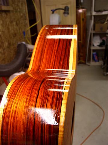

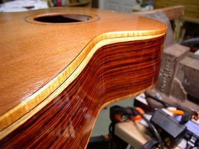

The Z-poxy has a nice amber tint to it, it really warms the wood and pops the grain. I believe the system 3 is clear.
Here is some coco coated with z-poxy
LanceK38372.4127199074
PostPosted: Thu Jan 20, 2005 2:07 am
I know the subject here is finishing... but dude.... that dark purfling line against that sap wood is GREAT!

Gee Lance, that's a boring looking guitar....
You're not charging someone for that are you?
