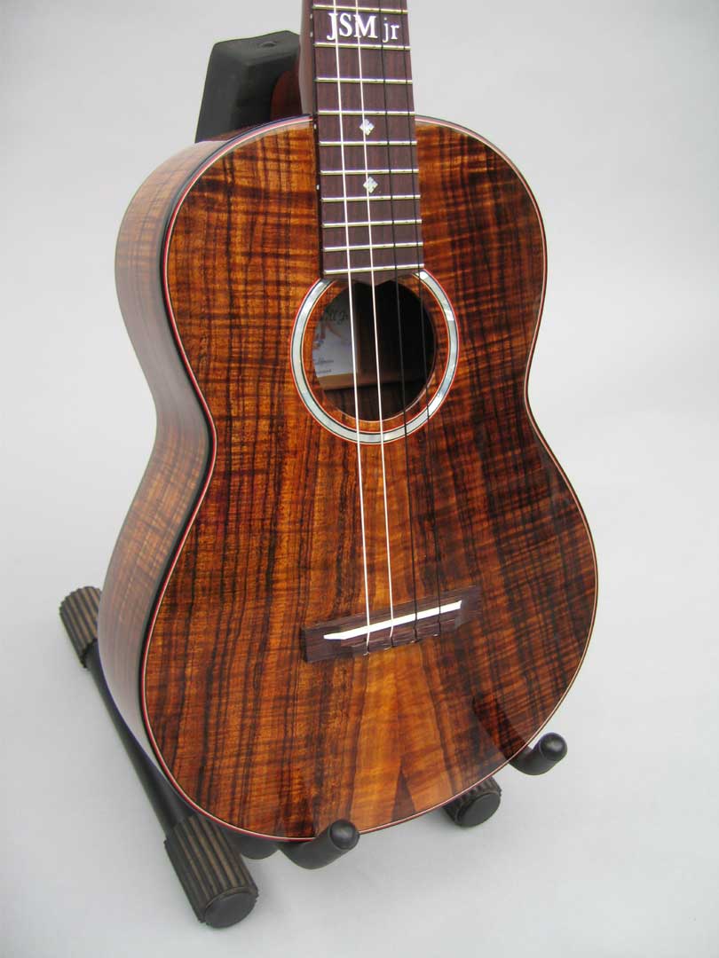

Well I finished my 1st UKE!!!!! This was a total guess!!!! I had no idea
what to do to build this one. Bought a book, emailed John Mayes, and
then adapted!!!
Intestesting story. Well when my first commission was delivered in Dec,
another collegue saw it and said. "can you make a uke" I said "I don't
know, but I can try" Well this nurse wanted one for her father who is
retiring from the military after 38 years. He loves ukes and she wanted to
have a custom baritone made for him as retirement gift. Once I accepted
the challenge, she then told me the hook!!!!!!
IT IS TO BE PRESENTED TO HIM AT A WHITE HOUSE CEREMONY!!!!!
Ouch!!!!! Well it looks nice and I think it sounds fine, but I have NO
means of comparison!!!!
Baritone all Koa uke, EIR bridge and fretboard, red/white/and blue
purfling. MOP and Red white blue rosette. I figured I better make this
one patriotic!!!

WOW, Andy, that is really really beautiful. Nice story too. Do you get to make the presentation???
Great job.

That Uke Rocks!!!

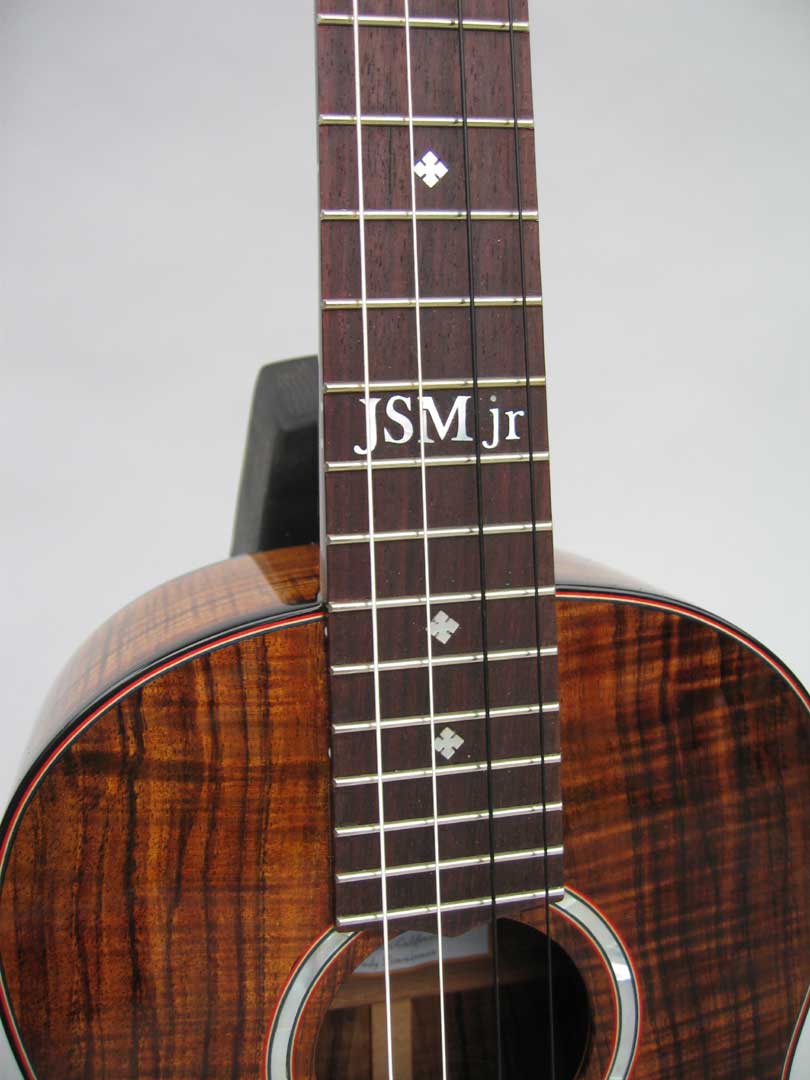

I really like the details...
What is the binding and heel cap??
Now I have something to shoot for when builing my sample for the class, I LOVE the FB inlay dots..
Great Work...
-Paul-

Man,That koa is so nice,and great job Andy. Neat story
too!

Thanks!!!!
Paul, the binding and heel cap are ebony

Wow! Or should I say, "Bow Wow!"? What a nice looking instrument. What did you do to that koa? It looks terrific.
PostPosted: Sun Jul 30, 2006 2:12 am
I did nothing to that Koa. That is the way it came. I bought this set of Koa
from Big Island Acoustic Koa in Hawaii. They are not Sponsors, but Josh and
Karen are great to work with. I was in need of a baritone set, but one with a
lot of curl and they would e mail me picts of what they had.
I picked this set despite it being dark, because of the patern and flame
PostPosted: Sun Jul 30, 2006 8:23 am
[QUOTE=azimmer1] I did nothing to that Koa. That is the way it came. [/QUOTE]
Ain't nature wonderful?
