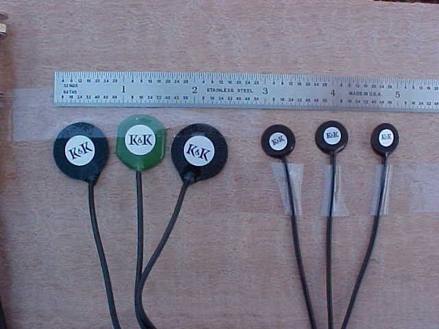

Here is a comparison photo of the Standard and Mini Pure Pickup system for steel string. Standard .775", mini .490" on the transducer size.
Dickey38376.5109259259

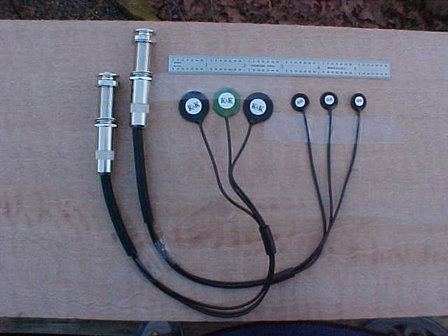

I have the standard Pure Western photo up on my site. It's the triple transducer wired directly to the endpin jack.
The endpin is a stereo setup, but works with a single output source such as the triple transducers. Later, an upgrade including an internal gooseneck mounted microphone will tap the second channel of the jack.
A basic system is just the triple transducer, standard or mini size. Any adjustment to the sound must be made at the guitar amp or an additional unit such as the Pure Preamp.
An upgrade to that would be to add the Pure Preamp, which is connected via guitar short guitar cord to the belt clip unit. What that gives you is external control of Bass, Mid, Treble, and volume.
This in effect becomes half of a Trinity System which uses a dual channel belt clip preamp unit. On that unit, you may externally blend output from the transducers and the microphone. Inside the preamp are two sets of adjustments for each channel, bass, mid and treble trim pots to dial in your sound, also adjustable via a gain is 1 to 10 power enrichment of the input signal. The batter is installed inside these preamp units, not in the guitar.

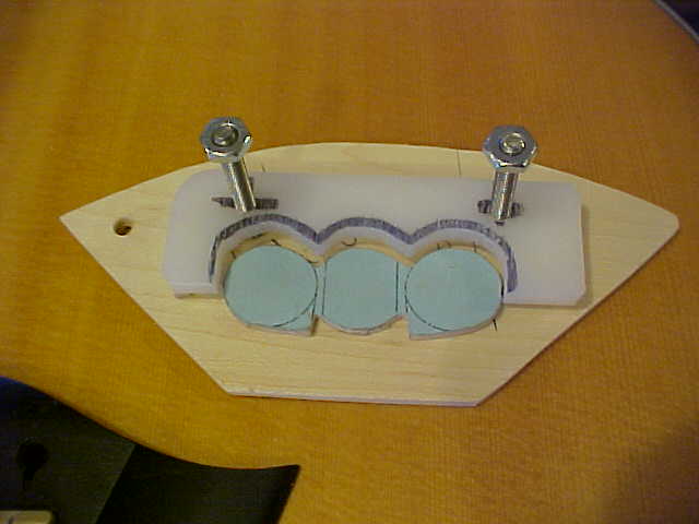

Bruce, any chance of a picture of the alignment tool? I'll have to be installed these things on two of the three next guitars I build, so inspiration would be nice!
PostPosted: Tue Jan 25, 2005 4:55 am
Sure, I do recommend one change. Drill all the bridge pin holes through the tool and it helps you see where you are and need to go. I did one without the tool and one with the tool. Believe me, the visual clues are important, but then having the cavity for the transducer is really perfection.
This is actually a slice off my wife's cutting board, cut in half / resawed, then bandsawed to shape. Go ahead and drill the other four holes and you'll be glad you can actually peep in there and see where you are.
You may recognize the little blue paper diagram. It comes in the kit and I took it a step further gluing it to a piece of maple and sawing it out. I can pop it in a guitar and see if the transducers will fit in just a jiff...
