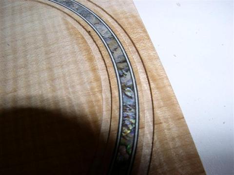

This is a rosette I made using a fine slice of flamed maple Steve Roberson sent me, its going into the 12fret dread, also the top is Carpithian Spruce from Steve as well.

Nice rossette Lance. I like the Combo. How do you like that Carpatian spruce so far? Been meaning to get some.

Lance,
Nice! Looks really sweet.
One question, is it 3 diffrent pieces, wood, shell, wood, or is it one piece of wood with a channel for the shell?

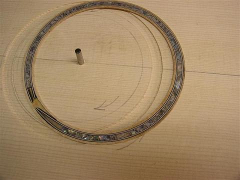

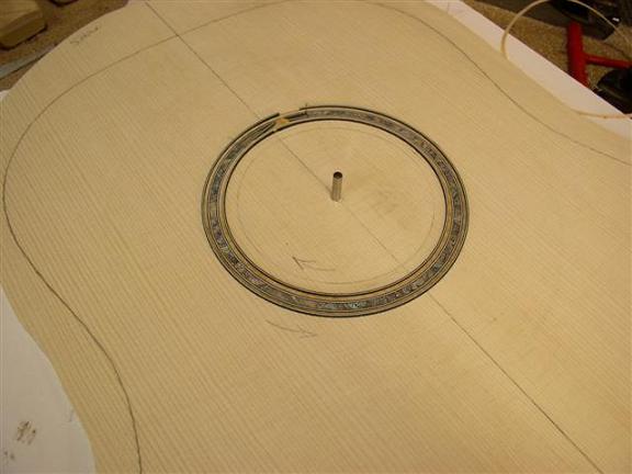

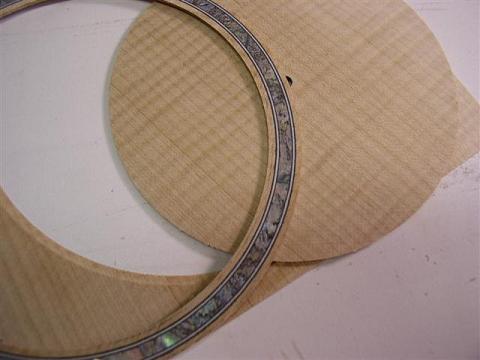

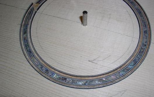

Thanks Guys, here are a few images on how this rosette was made..
Start with a 3 piece Red Abalone heart inlay
Here its inlaid into a flamed maple blank, along with a b/w/b strip on either side, the deep channles are where it separates when I run it through my thickness sander.
The channels are as deep as the ablone is thick.
Here it is after having been ran through the sander, you can see how its come apart from the blank.
Finaly, its inlaid into a channel in the top, along with another b/w/b purling.
LanceK38375.3683101852

It looks wonderful! I don’t think I can hack it without a thickness sander though.

Colby,
It's still easy without a thickness sander. All you have to do is route the channels a little deeper until they go through to cut it out. I like how simple the sander is, but you shouldn't have any problems the other way either.

This is the same way I do my snakewood ones, I make an octagon with the snakewood and center on a piece of scrap and then route and cut out the piece before inlaying it into the top. I run it through the thickness sander to get it to release, you don't have to do that but it's easier to route these with a more solid base under them.
I'm now starting to use a vaccum jig to hold my rosettes so I don't need as big of a base and can but them free from that by just going deeper..

Why doesn't the sander throw the rosette across the room? After you sand away the remaining wood, what is holding the rosette in place or am I missing something?
PostPosted: Sun Jan 23, 2005 12:11 pm
Posts: 8559
the sander has pressure rollers that hold the whole thing down plus, I use my fingers to add pressure on the infeed and out feed.

[QUOTE=Mike Mahar] Why doesn't the sander throw the rosette across the room? After you sand away the remaining wood, what is holding the rosette in place or am I missing something?
I think that's a grand question...because, pressure rollers or no, if this were done in MY shop, that rosette would be imbedded in some wall, or crashing through a window. Lance has the touch.

What is the specs on this? What size Ab are you useing, and how much maple are you leaving?
(Not planning on copying it exactly, but I like your dimensions.)
