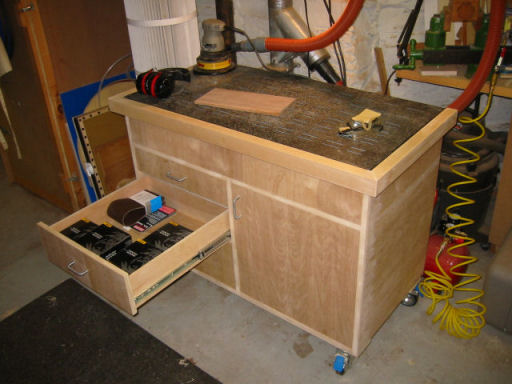

Here is a shot of my setup. The cabinet provides a very solid base, and some much needed storage. The downdraft is the Delta model, which is virtually identical to the Grizzly (expect for the color).
I have the small Oneida cyclone. Plenty of suction. Excellent for hand sanding and using the PC rand-orbit. With this setup, there is no dust in the air - just the noise from the sander and cyclone to deal with.
