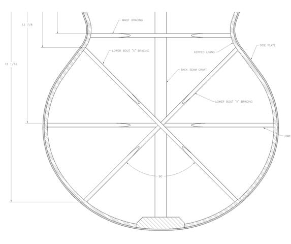

I have what I think is good news. I was able to get revised files that have my redesigned X-back brace to Lance before he sent the order out for printing. This revision has more of a Star shaped lower bout back brace option as apposed to the first iteration that had an 86deg X shaped back brace option. This revision supports the dome on the lower bout of the back better. I hope everyone enjoyes

PostPosted: Fri Aug 25, 2006 2:53 pm
There is no structural failure issues with the old plans back X brace but right near the apex of the lower bout the old x brace would allow the dome to flatten about 1/2" from the edge a bit. This was due to lack of a structural member to give the shape in that area. So I increase the angle of the X to 90 degs and added a spar on either side at the apex of the X that solved the flatting of the dome near the edge of the Lower bout apex. That was the only reason for the change if you look at the pic I included it is easy to see what I did and why. There has been no noticeable change in the tone but I have only done the new system on 3 so far. But it does make a big difference in the shape of the backs dome. Much better now.MichaelP38954.9997106481
