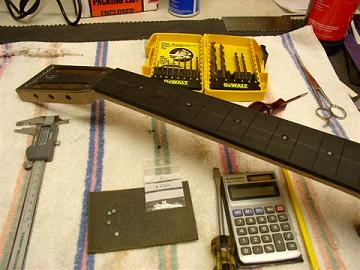

Believe it or NOT! I drilled and inlaid the fretboard markers in the wrong positions DHO! My only excuse is that both my little girls were in the shop with me most the time during that operation, and I was nearly done when I looked and thought SOAB!
LanceK38389.5828472222

I did drill out one of them, filled with Ebony and CA, but it still shows what looks like a shadow dot. So, I'm redoing the board, I emailed my VERY kind, patient and considerate client and he said "This is no big ting, mon."
