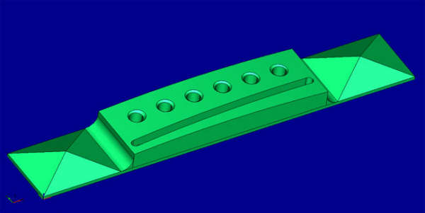

Let's see if I can post an image here....my first 3D solids drawing, done in the demo version of the CAD/CAM software I bought. I'm also going to buy Rhino, and do some stuff in there as well.
PostPosted: Mon Jan 28, 2008 11:53 am
Hey Don,
Congrats on the pyramid bridge. That looks really awesome. Have you cut one yet on your machine? I am getting a LOT closer to jumping in ;)
