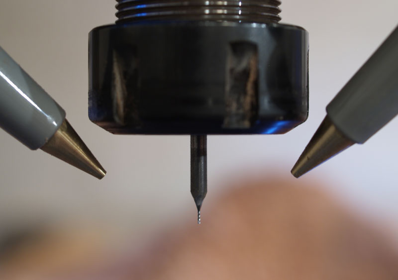

I've been doing some fret slotting in ebony and rosewood and I'm also writing a short article about the process with RM Mottola. I just wanted to see if anyone else was slotting, and whether they'd be willing to share info about feed rates, etc.
My machine is a sturdy DIY machine with a heavy aluminum frame and a 2.25 HP PC 892 on it. Steppers, ballscrews, linear rails, vacuum holding for parts.
Based on the Onsrud datasheets and the RobbJack Calculator, I've been working in the feed rate range of 12-25 IPM, taking about .015"-.020" depth of cut, with a .023" endmill spinning at 23K RPM. This gives a chip load/tooth of about .0006" at the higher speeds. No problems at these speeds.
I've seen references to taking full depth (.080"+) cuts at equivalent speeds (25 IPM), but I'm nervous to try this and the forumlas don't seem to support this kind of aggressive work with a small cutter.
Any thoughts or practical numbers for me to work with before I start breaking bits?

Steve I use the .020 and .023 bits for inlay and for fretting, what helps the most I've found is to take shallow passes. There's a trade off on how long something like this takes, I keep my IPM pretty low (down in the 8 -14 range). The big trick John taught me was to try and keep the slot clear so the bit does not overheat, I run a huge dust collection system and have a full dust shield built into my CNC machine to help as much as it can.
Regardless... I still break them more than I would like, I think it just comes with the territory :)

I think if you are running in the 12 to 25 ipm range you are doing well. Those are tiny bits and it is very easy to abuse them. I usually run on the low side of that range just to stay on the safe side.
I also cut my slots along a radius. I don't have enough depth of cut on these tiny little end mills to do anything but that!

The feeds and speeds at precisebits.com work pretty well. I use those and add a little speed until the bit sounds wrong.
John was the first to offer boards slotted like that commercially, but others have been using similar construction for a long time. I'm pretty sure Thorn guitars was the first, although other makers have independently come across the idea (Kevin Ryan did, without knowing who John or Thorn are).

Thanks, this is helpful. I'm also cutting these slots at a radius that matches the fingerboard. I think I first saw this done at least 3-4 years ago, but didn't know who to attribute it to. It does make for a stiffer fingerboard.
The feed rate/chip load formulas seem to indicate that 25 IPM is about it for a 23K RPM router. PreciseBits states that you can take a full depth (.100") cut at 25 IPM at 40K RPM. This is a 3 flute cutter with some improved geometry for the task at hand - so that seems reasonable as well.
For the time being, I'll stick with my lighter passes and 25 IPM (or under) feed rates for fingerboards. For pearl, I'm going about 6-10 IPM. Maybe I'll try a few bits from PreciseBits and see if I can't push them a little harder.
Climb cut (clockwise) or not? I tend to climb cut almost everything (a lot less blowout), but wonder if that might make a difference as well.

I've been using 1/32" 4 flute bits in pearl and for general inlay work, and they do work very well. The PreciseBits "fret mills" come with a 3 flute geometry, which may also provide some extra rigidity. I am going to try these.
I considered using a .020" mill and routing a profile to a width of .023" or .024". That seems like a reasonable approach, but slower. My .023" endmill is producing slots around .024" in width, so there is a little bit of positional inaccuracy or runout at work. Not suprising with a regular wood router and rolled ballscrews.
Even so, I think the accuracy is pretty amazing and this is a good slot width for most fretwire and I am very happy with the results. I wouldn't expect most benchtop machines to do any better with such small mills and taking 4-6 light passes to cut the slot.

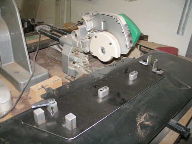

I've cut slots manually and on the CNC.  For production I've gone back to manual. Total time on the manual machine is about 1 minute.  On the CNC 15 minutes or so.
It sounds like my setup is similar in concept to Rick's Alembic machine.  Although I bet Rick's was a lot more robust.
Mine's made from a Hitachi sliding compound miter saw.  The blade's a HSS hollow ground screw slotting blade.  It's probably done 500 necks or so and still has lots of life.  I machined a corian blade guard that doubles as a depth stop, tracking over the pre-radiused fingerboard.  The sub table and neck fixtures are made from laser-cut 1/4" steel.  On the sub table there are two indexing pins directly under and inline with the blade.  The neck fixture has a hole and a slot for each fret slot that locate on the table pins.
The neck fixture holds the neck during 3 processes, radiusing the fingerboard on an edge sander, cutting fret slots on this rig and routing the nut slot on a pin router.  The cost of the last fixture was about $50.00 for the laser work plus a day's labor on the bits and pieces.
