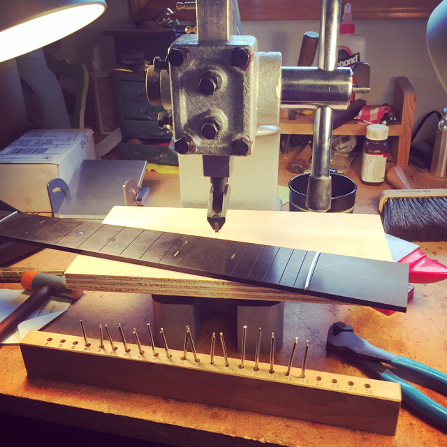

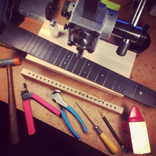

I use an arbor press with the brass cauls whenever possible - carefully selecting a caul for the exact radius of the fretboard. Makes for a beautiful fit, no chance of hitting the fret board, and much less work leveling later. (I no longer use the fretting hammer in these photos, I've switched to a brass head dead-blow hammer for seating just the very end of the fret before pressing)
If the arbor press isn't an option then its the Jaws II and a small brass head dead blow hammer.
