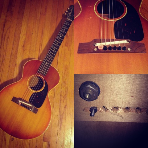

I've been asked to reglue a bridge on a 1961 (probably) Gibson J45. Interestingly the bridge is plastic and is kind of hollow inside. It has some little nibs that locate it on the top and at one time the owner had run some screws thru it before asking me to fix it right.
I see two options - reglue the original bridge or remove the finish from the footprint and replace it with a wood bridge. If I decide to reglue it what would the best glue be - I would think maybe epoxy but that wouldn't be correct to the period. And I guess a second question - was this common and why did they do it?

Yes this was common. They did it because it made building guitars alot easier (cheaper). usually this is common on B25s LG's and a few rando models through the years. VERY odd that it was on a J45. I don't have this guitar in hand so I can't date it but I doubt this is a 61 that's a different discussion though.
Before you do any bridge work can you send a picture of the bridge plate?

No point in trying to reglue that which was never glued in the first place. It was fastened down with four sheet metal screws from the inside. As a point of humor, Gibson actually packed a note with each guitar touting the superior method of "mechanical" bridge attachment, also mentioning not to worry about the gap seen between the bridge and the top.
Cheapness at its best.
Jettison that old piece of _____________ and make a nice wood replacement, scrape the finish, glue it properly. Quite often the plastic fails at the screw holes anyway.

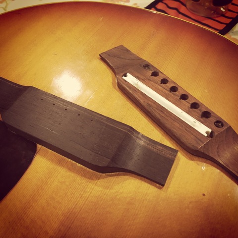

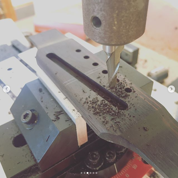

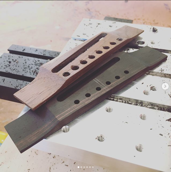

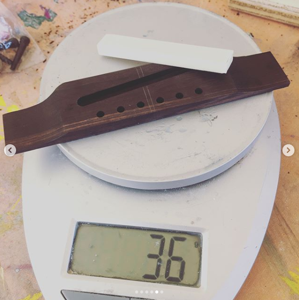

Slightly different screw/bolt configuration, but here is how I approached a B-25. I made a wide bone bridge to look like the original and give me more play for compensation.
One thing to consider is that the move from a plastic bridge on that J45 to Ebony is going to increase bridge mass, which has an effect on tone. The net benefit is there, as a well-glued wood bridge is superior to the bolted plastic, but its good to discuss.
In the case of the B-25, it was bolted wood with an adjustable ceramic bridge—a lot of dead weight. Making the switch actually cut the weight considerably.
