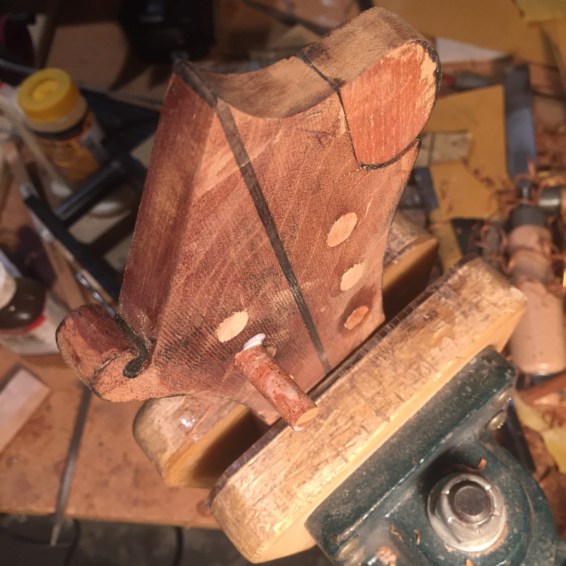

My favorite way to properly fill through-holes, with no risk of voids, is to use a tapered violin peghead reamer and matching violin peg tapering tool. You can then cut a grain matching stick/dowel, turn down to the appropriate taper and approximate diameter to fill the hole. Ream the holes with the matching taper, working slowly to only go as large as needed to get a clean cut all the way through. Hide glue, Titebond, Epoxy - there are cases to be made for each depending on the instrument and intent.
A few photos to illustrate the idea This peghead will be re-capped front and back with ebony/dyed pear (client wanted me to save the original if at all possible, so I'm giving it a try), grain matching was not a consideration. With your maple neck it will look best to ensure you plug with plain to rift sawn to match those distinct grain lines.
Cut some 3/8" blanks for making the tapered dowels
Chuck in a drill and add the 2° taper with a violin peg shaper
Ream the existing holes with a 2° and start plugging.
