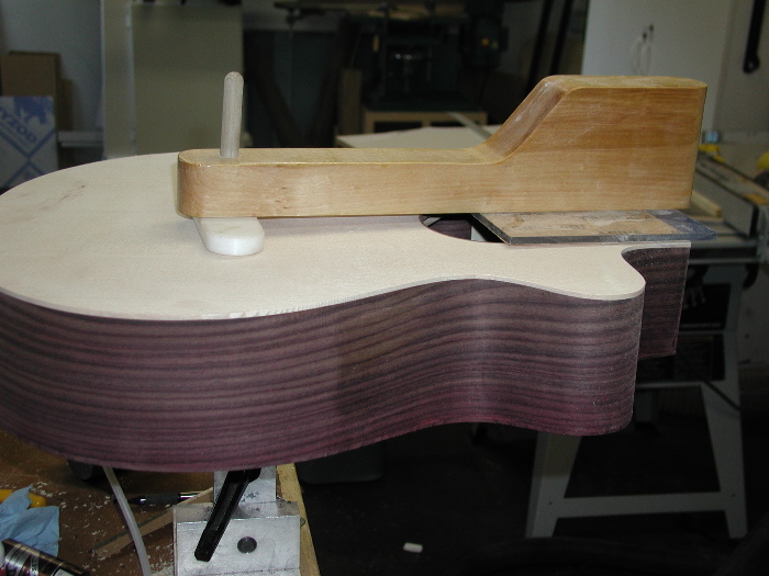

PostPosted: Sun Jan 15, 2006 11:43 pm
Andy, I got your PM but wanted to respond here so everyone could read it and perhaps comment further.
As Sylvan said, you need to design this into your guitars. It's an often overlooked detail and I think that reasoning might be because often times people just get lucky and it all works.
this is what some of us are doing. I know Lance uses a similar jig to flatten his tops at the right angle.
Basically the white piece of UHMW is the thickness of the bridge (plus the thickness of the plexi on the end) giving the perfect slope of the top. I just draw witness lines from the top of the soundhole to the neck joint and start sanding until they are done.
That said, I don't really like this system. I'm not too crazy about thinning the top in this area. So my next design will be for a router to ride on a set of rails that will be at the perfect angle, which you'll have to figure out what the perfect angle is in your particular situation. Anyway, the router will take the dome off of the linings above the soundhole and the neckblock and give them a straight angle instead.
There are several fixes to a hump or dip problem. The one that I've found to be the least obvious is to remove the frets, force the extension to make the hump or dip, glue it onto the top, and sand that fingerboard flat again. Once the fingerboard is flat and true, refret. You won't be taking off much material so it won't be noticable.

PostPosted: Mon Jan 16, 2006 3:27 am
Paul
Based on your above reply, I take it you build the box so that the slope of
the top above the soundhole allows for a perfect position of the bridge
(height). THEN using your neck jig, you can easily make the neck angle
match this slope.
Correct????
Andy
PostPosted: Mon Jan 16, 2006 4:23 am
Andy, yes you are correct. In theory, it's designed that way. Sometimes they don't work out in practice as well as I would like. But I see this as one of those "big picture" things. If you only concentrate on one issue, you'll neglect others.

PostPosted: Mon Jan 16, 2006 7:15 am
Terry, thanks for the correction, I indeed "double added" the thickness. So, yes, the UHMW is the thickness of the bridge and the plexi that holds the sandpaper is 1/4" which is the thickness of the fingerboard. Thanks.
