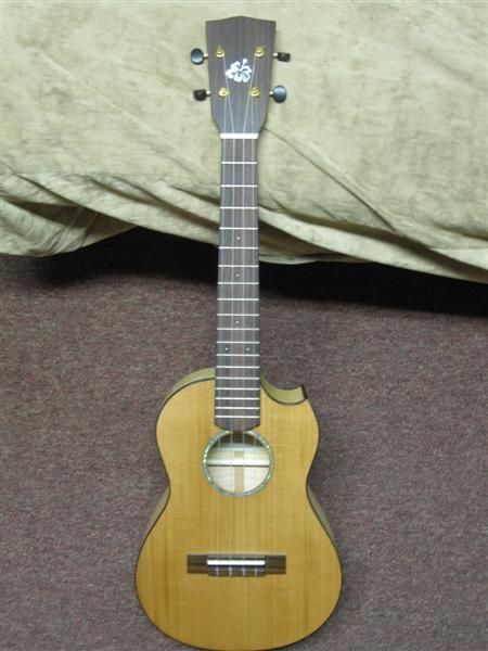

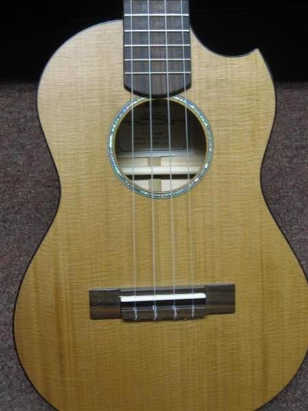

I haven't posted in awhile, and thought I'd share a couple of quick pics of the Uke I finished last summer. Cedar/Maple with florentine cutaway. Tortoise binding, abalone zip flex rosette and hibiscus inlay on peg head.
I had bought the rims from John Mayes about 3 years ago, and just finally got around to finishing. If you see this John, a big thanks to you!
Also forgot to mention that the finish is Pratt & Lambert #38 varnish in satin. Enjoy!

I really like this Tracy. The cutaway has an elegance about it. Very nice. [:Y:]

Very nice ! I like it.
What tuners did you use? They look just right!

Thanks Alain! I think the tuners I got from LMI. They are Gotoh open backs uke tuners and have adjustable posts that you can adjust up and down. They really work well and are really light.

Well that's just about the cutest darn cutaway I've ever seen. Nice Tracy.

Is that silk on the cedar? Almost looks like fiddleback. Wow!

I thought it was nice brown Sitka at first...
I (over) built a guitar from maple and cedar way back in the day (#2) which looked awesome but sounded like crap. Way over-braced. (Rookie mistakes) So now I'm wondering how this uke sounds with this combo.

Thanks guys! Really appreciate the nice comments. But I can't take credit for the shape, as John Mayes had already done that. I just finished it for him! However, the top was from some nice sets of cedar I got a couple of years ago. I think they weren't wide enough for a guitar, so I used one of the boards on this. I think it is just one board and not joint down the middle, but can't remember. I think I finished the top about a year ago. But yes, the silking on this piece was phenomenal!
I'm actually not crazy about the sound. I like more sustain and clear notes. This seems to have a little more muddy notes. On the plus side, it is VERY loud. It has 3 braces and a bridge patch, but are pretty thin and short. I'll try to do a sound clip tomorrow from my iphone.

Tracy, stop me if I'm telling you things you already know, but you might get a sound more to your liking with different strings. You might try flourocarbon strings, such as these
http://www.stringsbymail.com/store/wort ... 3hv5lg4v14
or these
http://www.stringsbymail.com/store/sava ... -7298.html
Another thought, which may be of no use to you whatsoever: as you get to know this uke, you may discover ways that the lack of sustain is musically useful. Depending on the musical context, sometimes short sustain is exactly what you want. Again, my apologies if I'm telling you things that are already obvious to you. Maybe you're an experienced uke player who knows exactly what you want in a uke. I only say this about sustain because it seems that just about every time I hear sustain mentioned, it seems to be with an assumption that longer sustain is always a good thing.

Todd,
Great information, and I do understand what you are driving at. I didn't really think about trying new strings, but I hear from some of my uke playing friends that strings really matter on a uke. So thanks for reminding me, and giving the links. I'll definitely try one of them out.
Your other thought about sustain is right on...Maybe my description was not correct. What I really mean to say is that this uke does not sound like a traditional uke. However, it does have a nice sound and can be used for certain types of uke music. I think it would be good in a studio or strumming in a group because it is so loud. So thanks for your observations.
