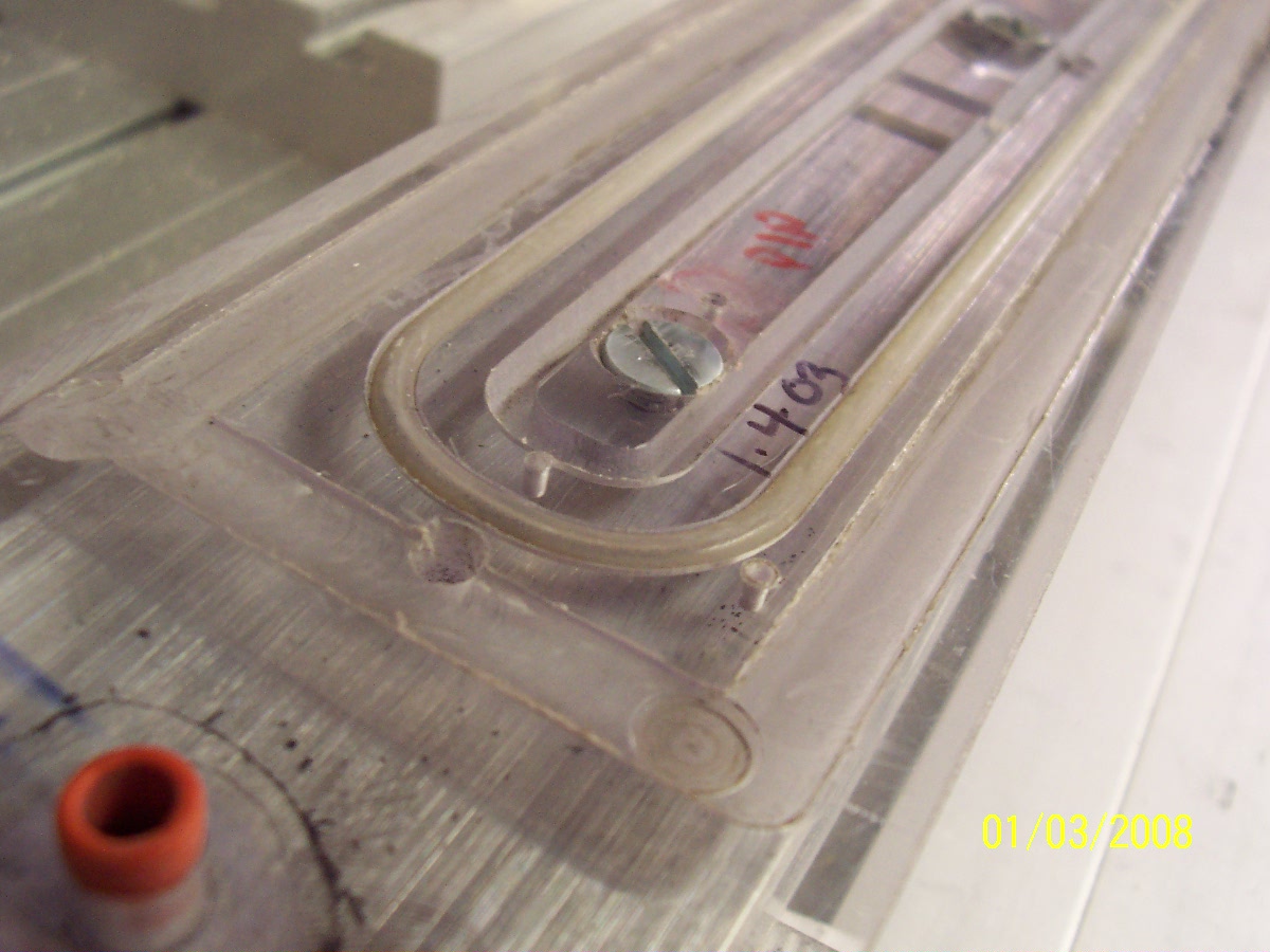

Mario--You mention distortion from "vacuuming" and that got me to thinking. (dangerous situation) I sometimes have trouble with vacuum not pulling parts down flat at the outer edges and I've always figured just not enough vacuum force. It may very well be just the opposite, too much force causing distortion, as you mention.
I do all the machining on my fretboards on the fixture pictured above and noticed the corners of the board wanting to pull up just a bit at the wide end. You suppose its the vacuum porting groove (1/4" width) being too wide?   Guess I need to try backing off a little on the "inches of mercury".

I leave 'support dots' under the part footprint on all my vacuum fixtures these days unless they're for very small and/or thick parts.
The majority of the area under the part is still empty, for good vacuum, but there are enough little flats left in the vacuum zone that the part can't deform.

Npalen...your vacuum jig design looks good, more likely than not your parts are not flat enough to begin with.
Another possibility is that your O-ring is not working as it should. Depending on the design of your jig, you could also be losing vacuum thru screw holes & such that mount the jig to the backing plate.

Thanks for the feedback, guys.
I do the finish radiusing of the fretboard after it is on the neck using a radius fixture on the edge sander.
