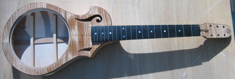

As there's not much going on here, and to celebrate the fact that the image upload has been fixed, here's that odd-shaped reso now it's a bit more together.

Very cool pete, love the retro/Maybell style and
beautiful woods!
This is travel unit right? Going to have a p/u at all?

That's Cool! I really like it. As Mike said, great woods and design both. Just fantastic!

You're right, Mike, it's a travel guitar with the 9 inch spider cone. I'll be fitting the usual Schatten pickup.

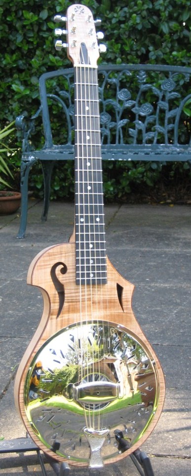

... and it's finished at last!

Dang thats nice!
I like the different looking resos, Matt Gage made a realy nice looking cut away reso a few years ago too.

Wow! Thats beautiful! How does it sound? how does it compare to standard shaped reso's? Can you give us a sound sample?

Brilliant as usual Pete. What a combo, a travel
'dobro' with a chicken-foot cover and Allen tailpiece!
Who's cone and spider are you using?

Sorry, guys, been a bit too budsy to do much web browsing lately. There's a sound clip at http://www.petewoodmanguitars.com/shared/BR_002.MP3, which I did as soon as I strung it up. It already sounded different the next day and that ring on the 1st string disappeared without my having to do anything. If it's like the others it will develop more depth of tone over the next couple of years.
It's a travel guitar so it uses a 9 inch dobro-style Quarterman mandolin cone - they don't sound like a full-sized dobro but it's still an interesting sound. In fact the squareneck version sounds a lot like an old tricone.
The spider is a mandolin spider from Paul Beard - they're not on the website but they still sell them. The bridge is offset so you have to think about the scale length a bit. I wish they'd make them with the bridge in the centre like the original Dobro ones.
