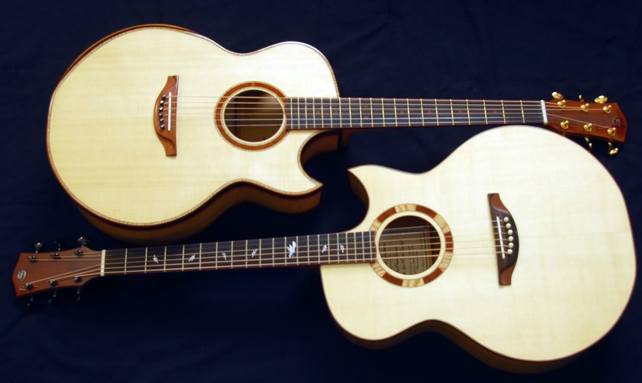

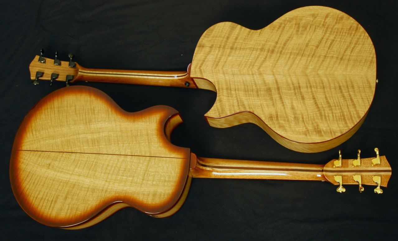

I hope you don't mind some pictures. I've made 2 with white oak - one Englishman and one Lutz top. I like the sound and I don't think it looks much like furniture.
