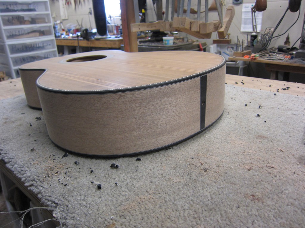

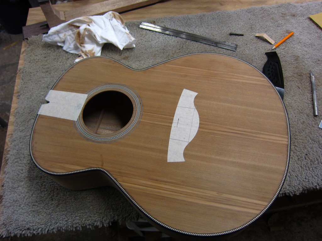

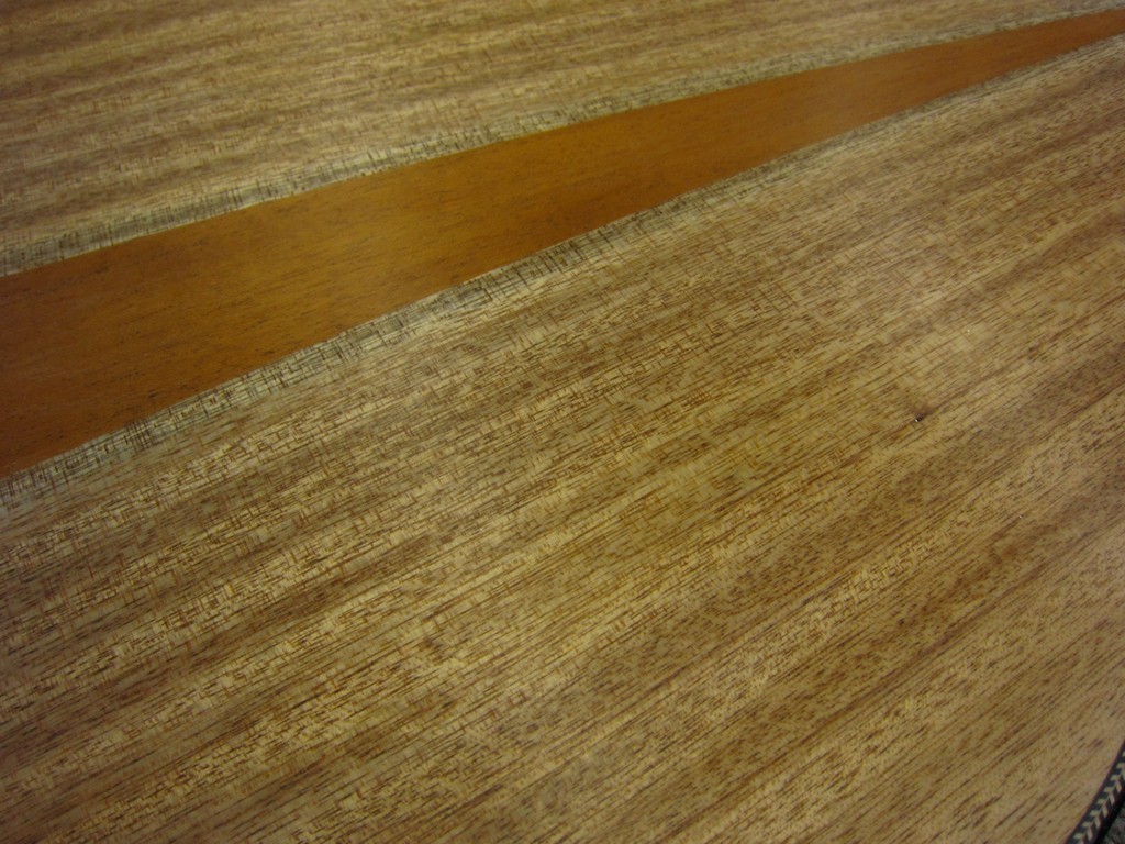

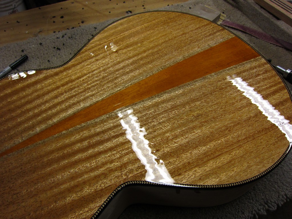

It's another Menards Special. bliss
Mahogany back and sides, multi-piece WRC top, rosewood fretboard, not yet pictured. Ebony bridge. Ebony binding.
Body shape is small jumbo, or as close as I could get drawing it from pictures.

Sweet. I'll be interested to see how you like the cedar top. Scale length? How did you brace it and how do you intend to tune it? (I'm a bit of a 12 string junkie)
I've used the same cedar on a few other guitars, and have liked the results so far. We'll see how it does with 12 strings on it.

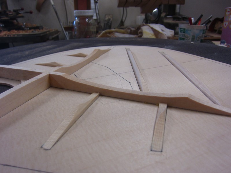

The scale length is 25.5" I used standard X bracing on it, but made the braces about 25% taller and wider than I do for 6 strings.
I'm not sure yet how I'll be tuning it. I'm hoping it will do well with standard as well as lower tunings. We shall see. :)

A picture of the bracing would be great if you have.

Sorry, I don't think I took a picture of the inside.

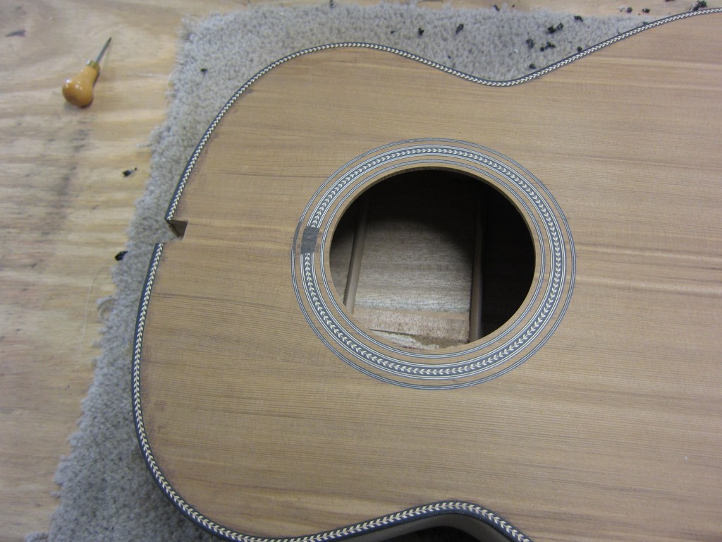

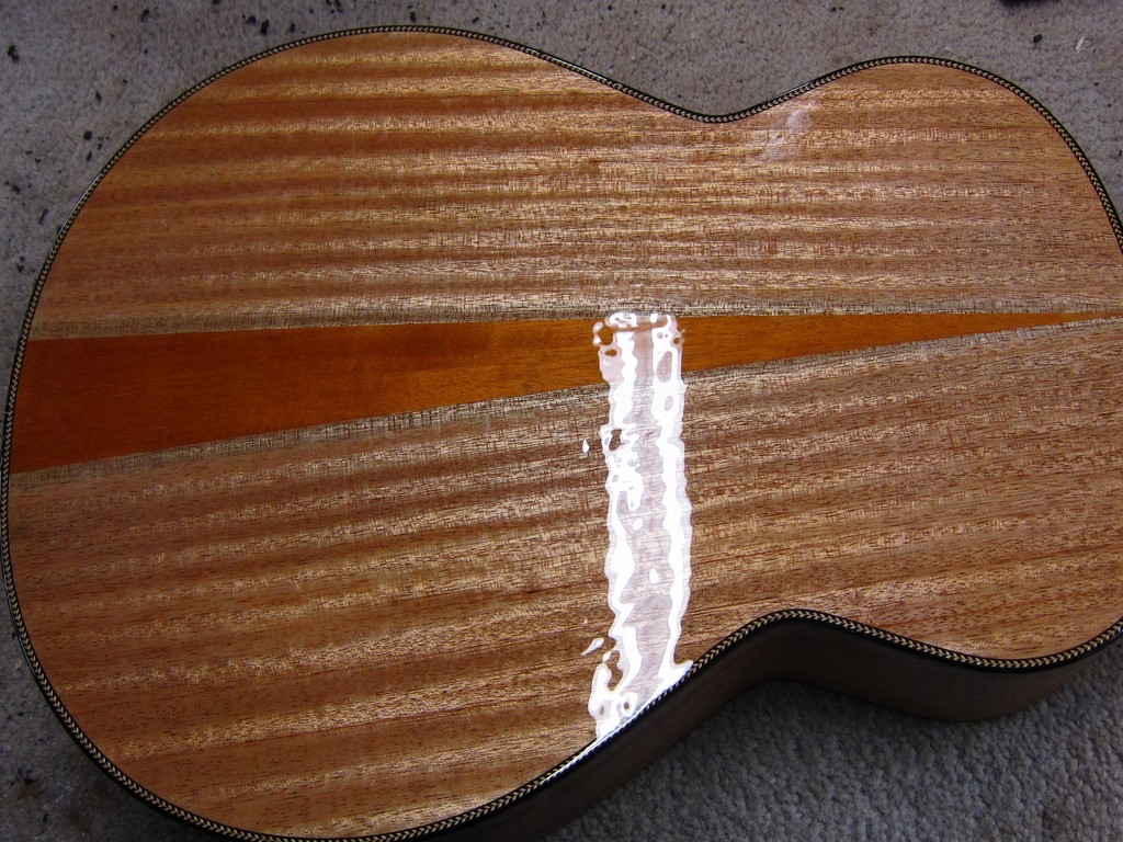

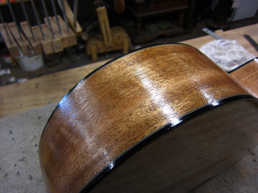

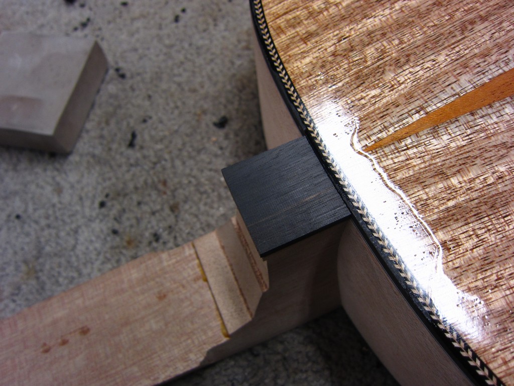

Got the neck angle set and the neck/body joint flossed:
Also got the heel cap glued on:
And applied some brushing lacquer:

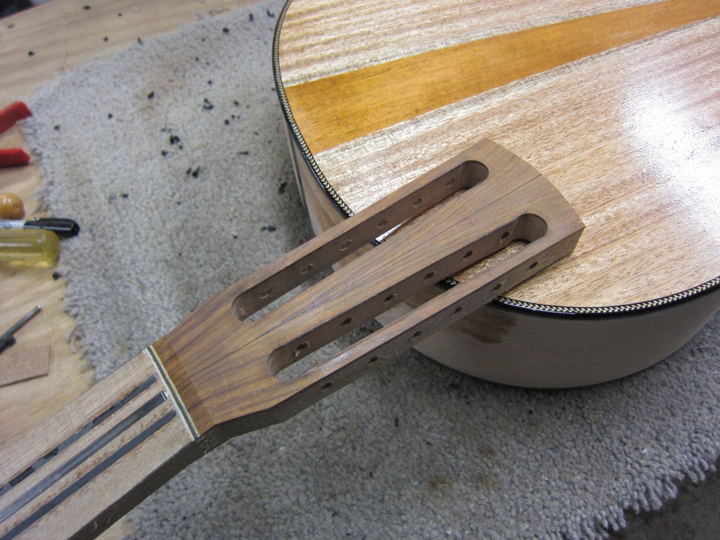

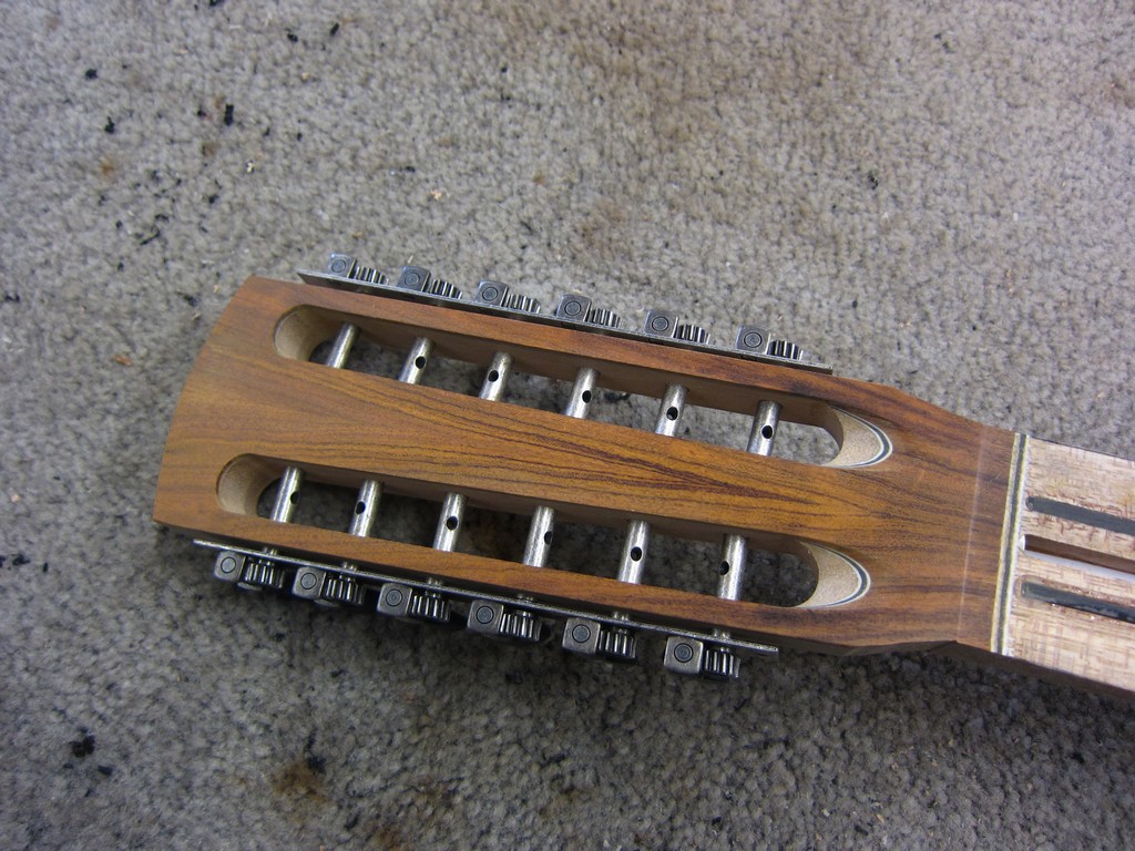

I can't say as I am familiar with too many slot-head 12-strings - your headstock looks great!

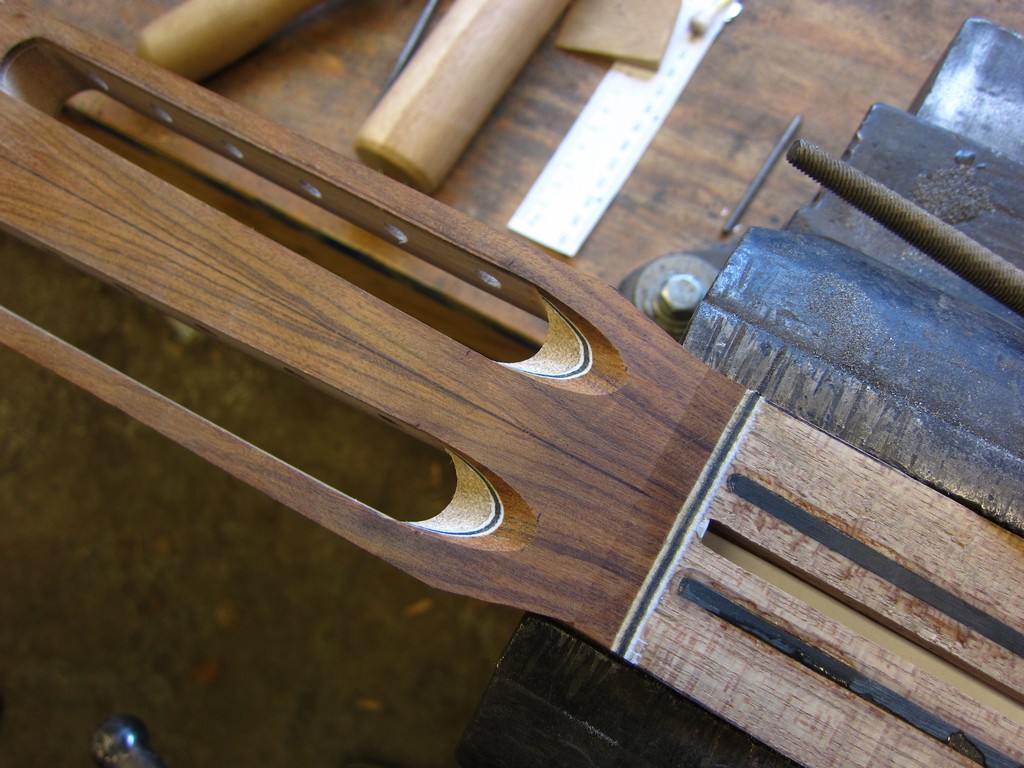

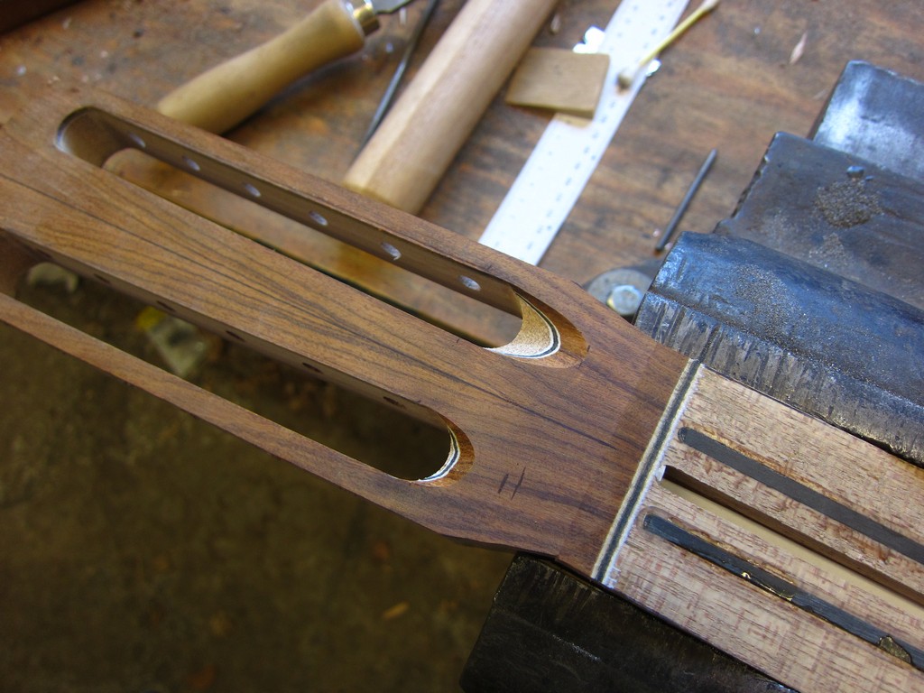

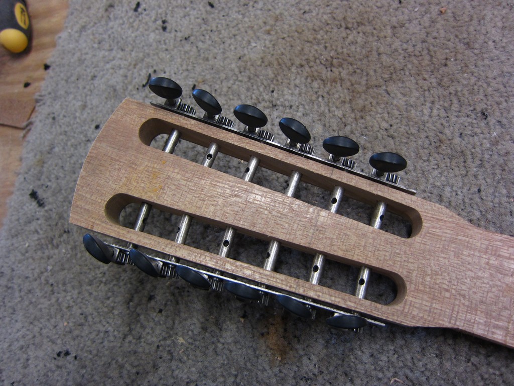

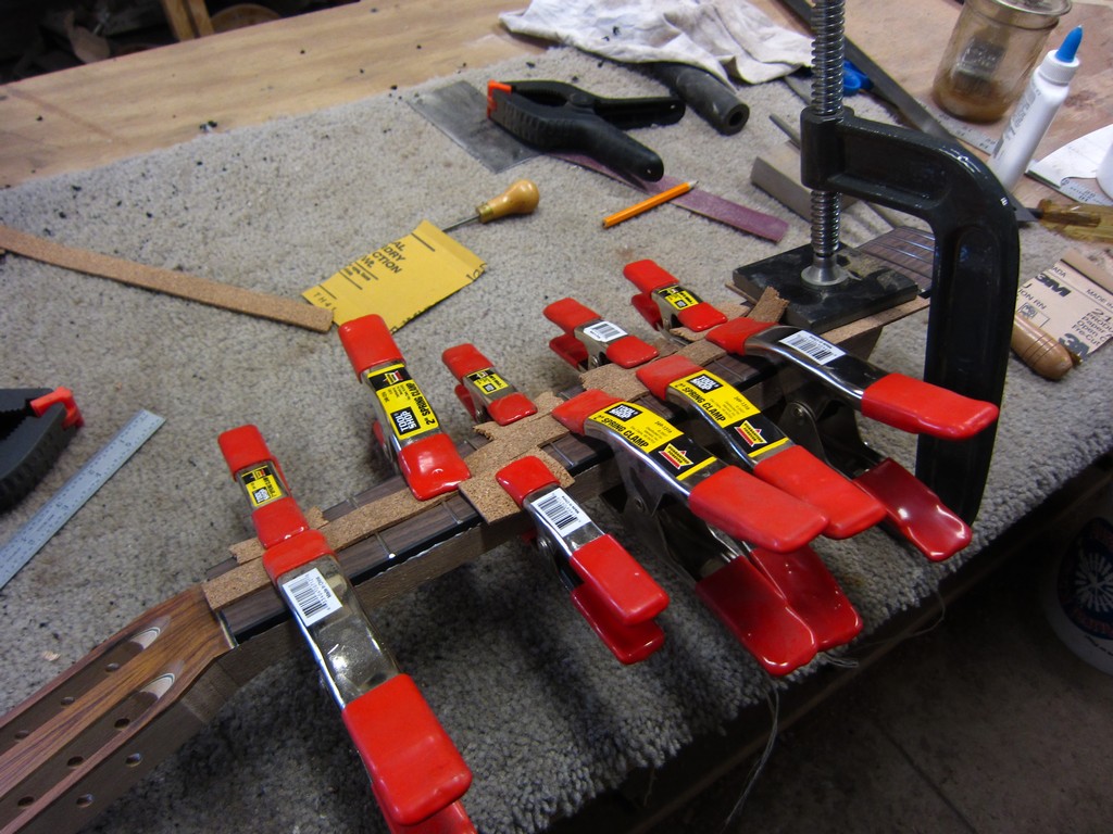

Finished shaping and polishing the headstock:

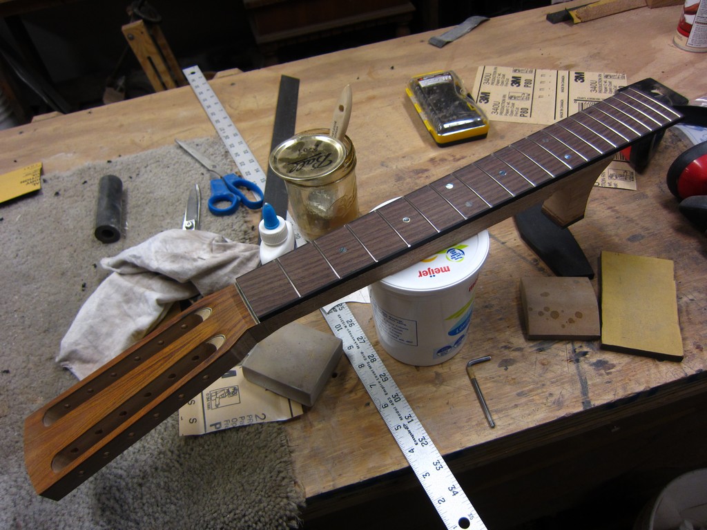

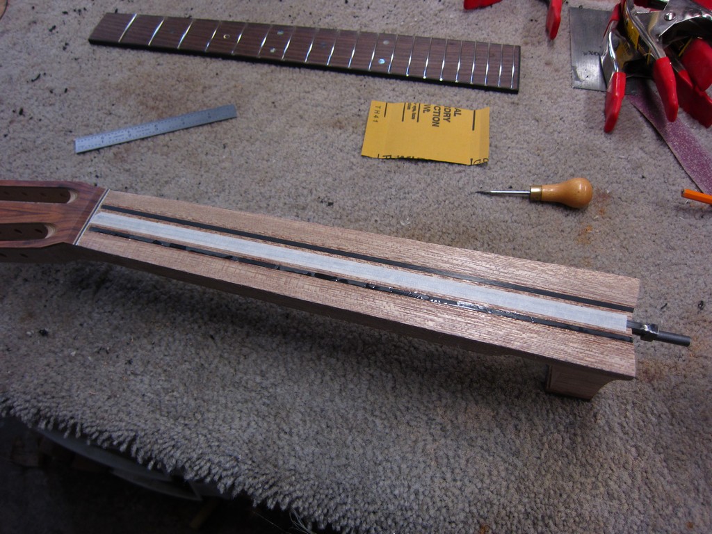

And then glued on the fingerboard:

Pore filling:
The fingerboard glued on:

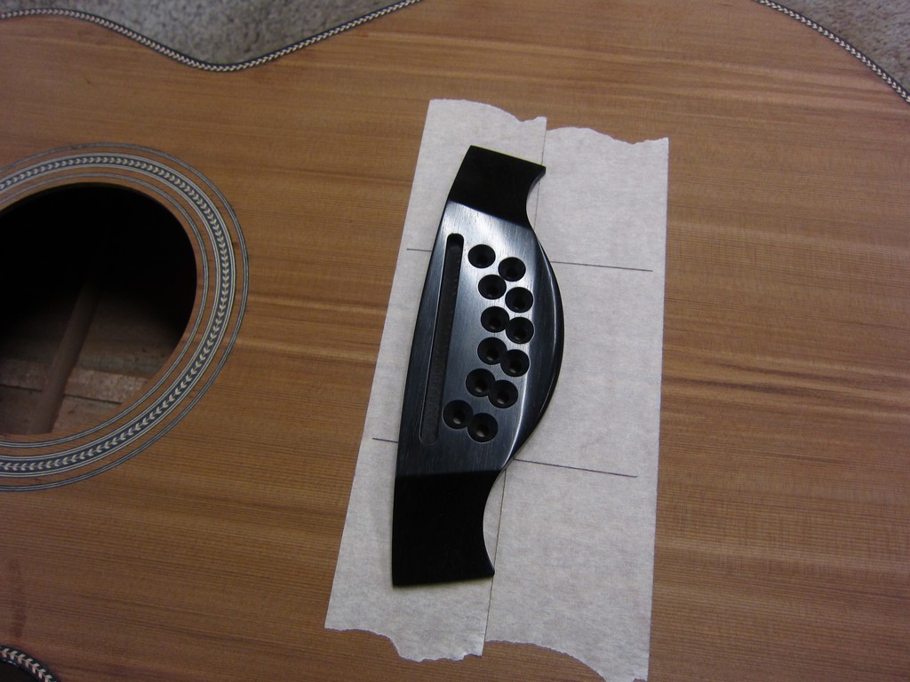

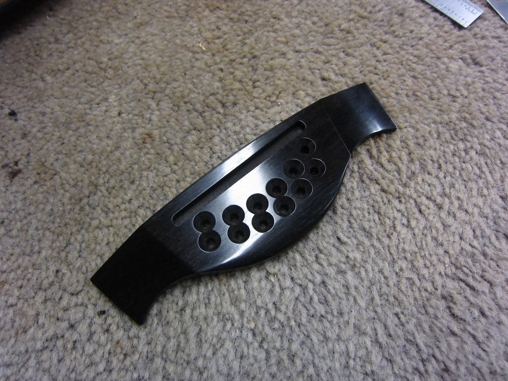

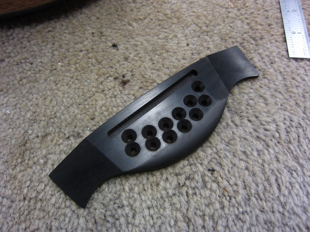

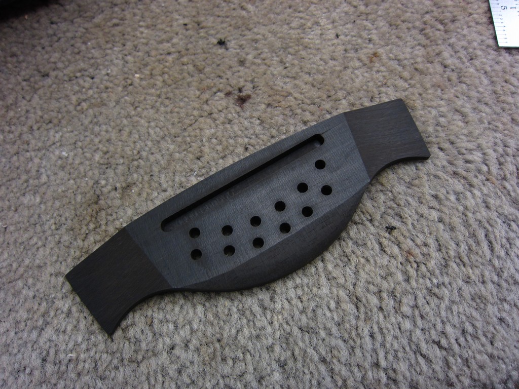

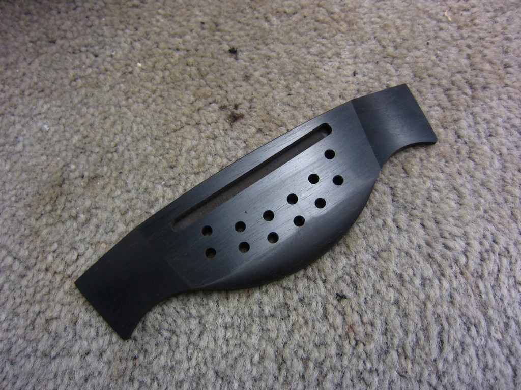

Did the bridge today:

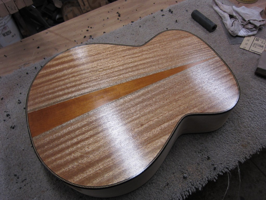

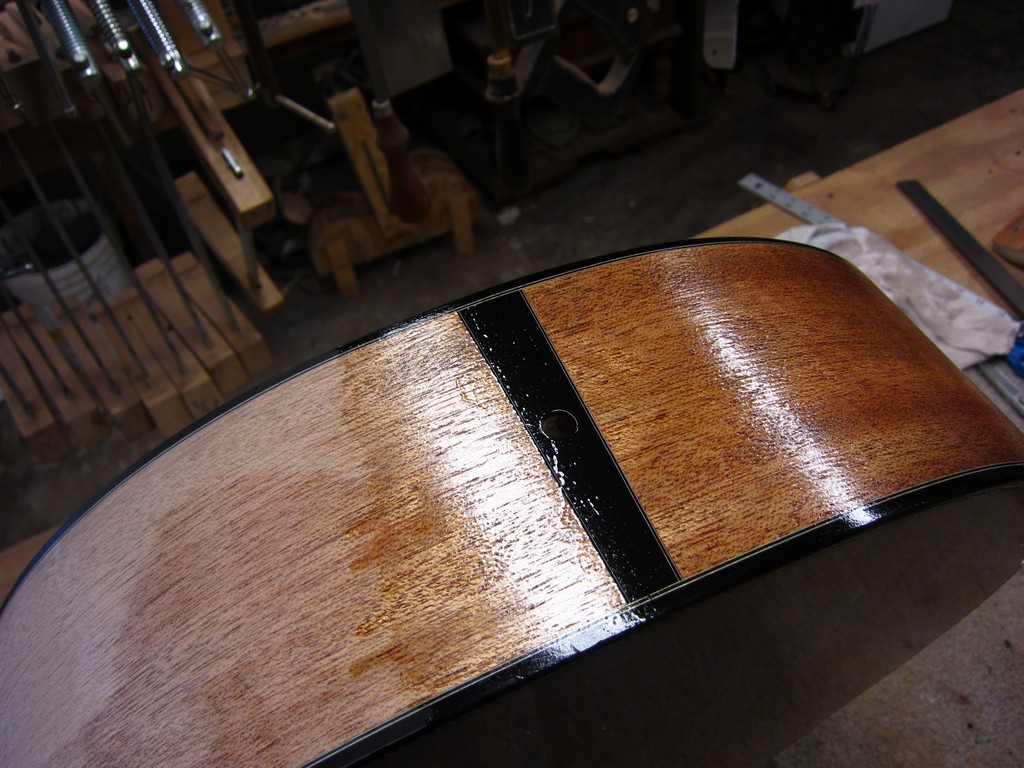

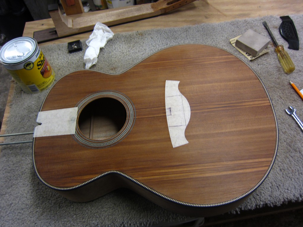

Seal coat of shellac on the top:
My hanging jig:
First coat sprayed:

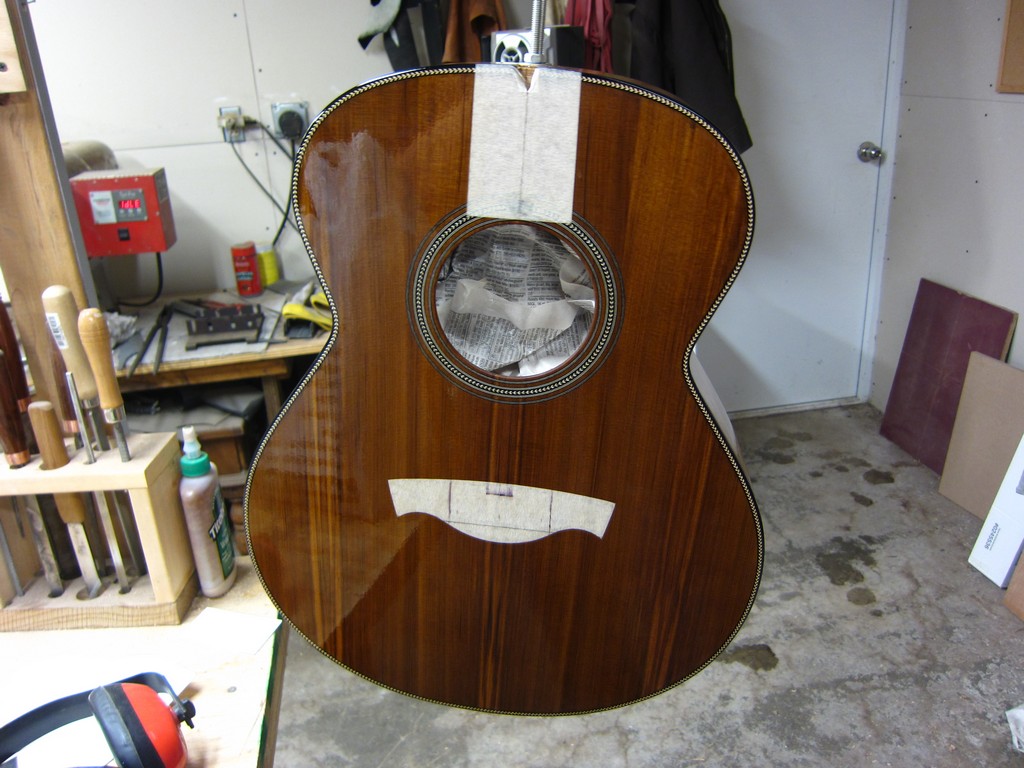

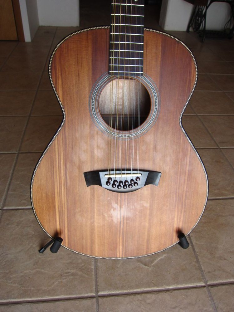

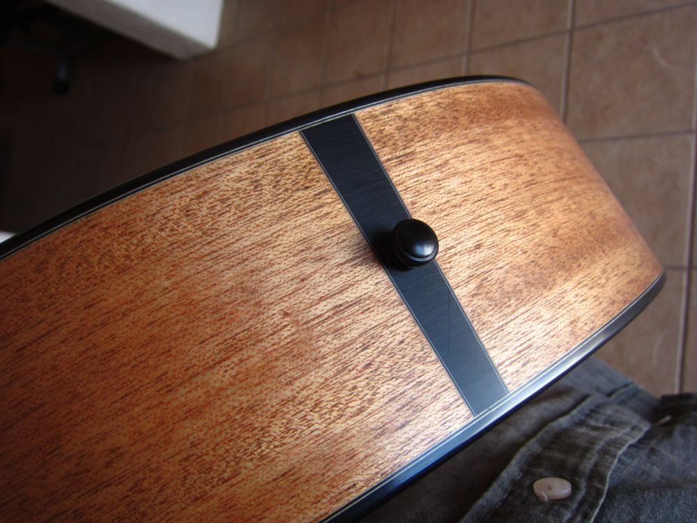

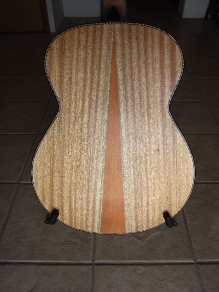

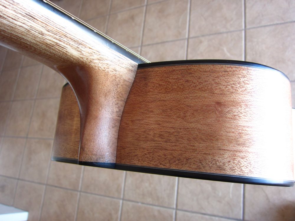

Well, I actually finished this one several weeks ago, but didn't take pictures until now. I got lazy with the finish and left it satin. I actually like it, though most customers probably are more used to high gloss. But this one's for me to keep. :)
bill stewart wrote:
That is one really nice guitar you are turning out although I have one concern and that is the design of the bridge. To me the bridge pin holes are a bit too close to the saddle slot and the countersunk edge at the upper base end is almost touching the slot. Would this not put quite a serious break angle on the string?
Bill S.
I think you have a good point. It's mostly just a problem with the low E course, but I will be changing the bridge design on the next one.

just curious: what type of tuning gears are those, and how long is the head stock? :P

These are "Golden Age Restoration" tuners from Stew-Mac. They're a whole lot lighter than regular tuning machines. This whole guitar weighs about 4 pounds.
The headstock is about 8" long, maybe a bit more.

I didn't work from plans, but plans are available somewhere I'm sure. :)
