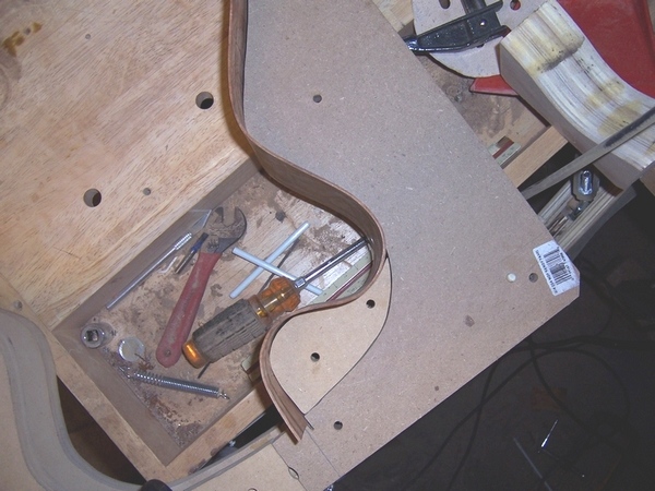

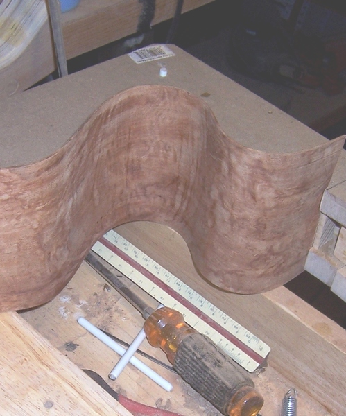

Well I bent my first set of sides for an actual commissioned guitar lat night with SSII. This is an extremely curly set of Narra from uncle Bob. From past knowledge I know this wood likes to separate at the change of grain orientation in the curl on tight bends. I have also had a bit of faceting issues in the past.
This bend was sweet. got to temp (310) in about 4 min. Bent the waist half way. Did the cutaway in maybe 2 min almost non stop. By the time I got to the back to do the lower bout. It had all but done its self. this photo is kind of an illusion due to angle taken I guess but the entry bend and return or horn bend both are only 1 1/4" radius
Anyway no facets no figure separation, no cracking of any kind at a .090" 2.3mm Just a smooth bend.

This set Did scare me a bit. I had treated the wood and wrapped in kraft paper as per the instruction on the bottle. When I removed this set from the kraft paper to prepare for bending it appeared that the SSII had discolored the wood but I went a head and bent the set assuming any discolor was on the surface only. After bending the discoloration completely disappeared. On the test sets of Narra you sent me and the other test sets I did there was no discoloration after the treatment dried. I was a bit worried but no problem in the end.
