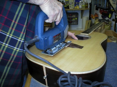

I just set up a guitar so I took some photos of slotting the bridge with my
jigsaw. See, I really do do it with the saw!

I just know I would saw the guitar in half
What sort of blade do you use Sylvan ?

Russell -
It was just an ordinary jig saw blade that I grinded down to a size that would
fit a 3/16" hole. Its' thickness is about the thickness of a big "E" string. I
have never measured it but the blades' importance is that it fit inside the
hole so you can start the saw in a straight line. It is very controllable and
reliable - as scary as it looks!

Jigsaw for me too. I have a piece of padded vinyl flooring cut the the shape of the top with a precise hole cut out for the bridge. Put the linoleum on the top to protect the precious finish and then you have much less worrys about using a power tool.
