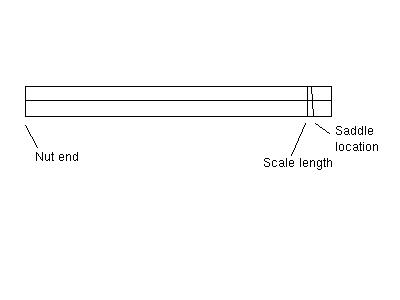

I based this jig of of something I saw in Julius Borges' shop. It took only about 20 minutes to build and made the job of lacating the bridge so easy that I'll take the time to make one of these for every scale length I use.
First, here's a drawing:
I used a drawing be cause the jig is polycarbonate and hard to photograph.
First I cut a piece of 3/32" polycarbonate to 3" x 26".
Next I clamp a straight edge to the center of the strip and score a line down the middle with an X acto knife.
Next I mark out my scale length (In my case 24.9") and with a square score a line 90 degrees to my center score.
Next I layout a line for my compensated saddle. I compensate the saddle by 1/8" at the center line.
I compensate the saddle by 1/16" at the treble edge of the strip of plastic. I chose to make my strip 3" wide bcause my saddle is 3" wide. I take a straight edge and score a line from the treble edge to the bass edge using my two compensation marks as guides. This new line is the CENTER of my saddle slot.
So far this is just like I layed it all out on paper as described in Cumpiano.
Next, I cut off a 3/16" by 2-1/2 inch piece of the 3/32" inch plastic. I sand one edge of the small piece of plastic and lightly sand a line on the other side of the platic under the score line I made for the compensation position.
I carefully clamp this small piece of plastic to the larger strip so that the score line is centered. I then wick in some solvent to glue this piece on. After 2 minutes or so I can remove the clamps. The jig is done.
Here is how you use it. Mark a center dot at on the fretboard at the nut position and at the sound hole position. Lay the jig on top of the fretboard so that the center line of the jig lines up with the center of the fretboard and the end of the jig is flush against the end of the fretboard. Clamp it down. At this point the small piece of plastic is in the exact spot that your saddle is supposed to be. Take you pre-slotted bridge and slide it up under jig so that the blastic slide into the saddle slot. The bridge will not be able to slide toward or away from the nut. It will have some play side to side. I put a center dot on the top of the bridge to line up with the center line of the jig. The jig hold the bridge pretty securely. Now you can mark around the bridge with your exacto knife.
I cut my jig so that it doesn't extend much beyoud the plastic saddle piece. This allows me to drill the 1 and 6 bridge pin holes. I use the Fox bridge clamp to mount my bridge so the pin holes are and excellent way to set the bridge position.
What I like most about this jig is that almost nothing slides around while your setting the bridge. You can accurately position a bridge in 15 seconds.

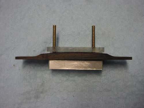

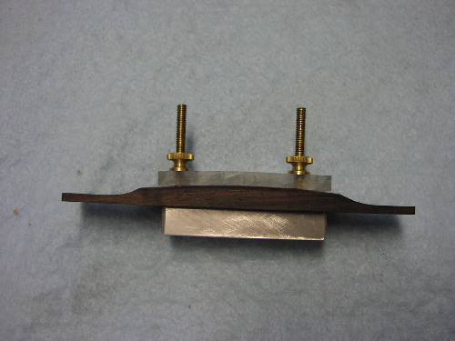

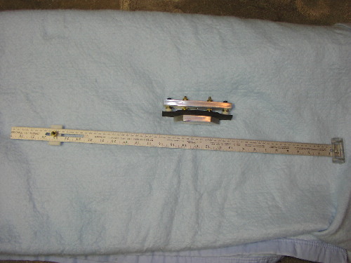

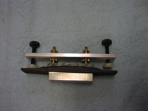

Hi Guys
here is the poop on my jig. the unit is laid out by the rule. You set the length. I add about .125 to the length. This helps when intonating. I tried so often to set them at dead length and never had a good result . Once I started to find the secret I kept going long till T stopped being sharp.
   With the scale set you drill 2 3/16 inch holes in the 1st and 6 th location. Wax the posts so glue doesn't form on the threads. Use the knurled nuts and lexan to glue the saddle area of the bridge . The wings are done last after you clean up the glue. Once the upper plate is on just lightly snug them on the wings. It doens't take much.

   If you look at the scale the unit is adjustable. The lower end will drop into the saddle slot for assured alighment and postioning. 2 3/16 holes are drilled so the clamp can pin the bridge and keep it from moving .
    The bridge is then glued on.
   This comes up through the and then the leaxan is placed over the bridge then the knurled nuts are tighten till the lexan takes the shape of the bridge at the saddle area Now you place the upper unit on and with the nuts on the post the toggle clamps secure the wings. I hope this makes the use of this clear. If you have any questions please let me know I want you all to be able to see how this works.

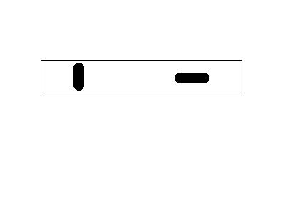

John,
I have a suggestion on a small but important change to your clamp. Make one of the holes through which the screws go slotted 90 degrees to the direction of the other slot.
I just glued up a pyramid bridge where the pin holes were parallel to the saddle. This caused the wing clamp to be severely off center on the treble side and I couldn't make the camp pressure even. If my jig had been slotted in the other direction I could have lined it up with the bridge and not the pin holes.

John, are the brass screws in the baseplate adjustable side to side? Or do you have to use the same pin spacing all the time so the screws will fit correctly?
PostPosted: Mon Aug 29, 2005 2:29 pm
Posts: 1542
The bridge clamp is adjustable to fit a 2 to 2 3/8 spacing. there is a cylinder the will open up.
