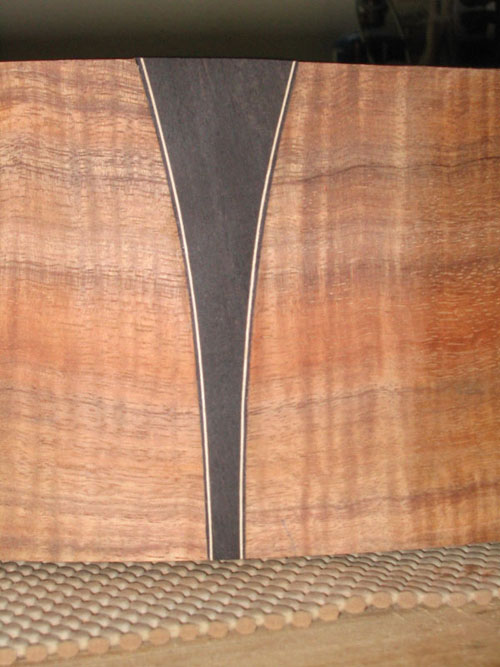

Here's a shot of my end wedge jig and the resulting wedge. I made it in about 30 minutes out of scrap. It was really just meant to be a one time jig, but I've used it now on my last 4 guitars. It's not adjustable, but I think I can make it adjustable pretty easily. I set it up to work with my dremel and a 1/4" bit. You'll see I've marked it that way to remind myself.
The resulting wedge:

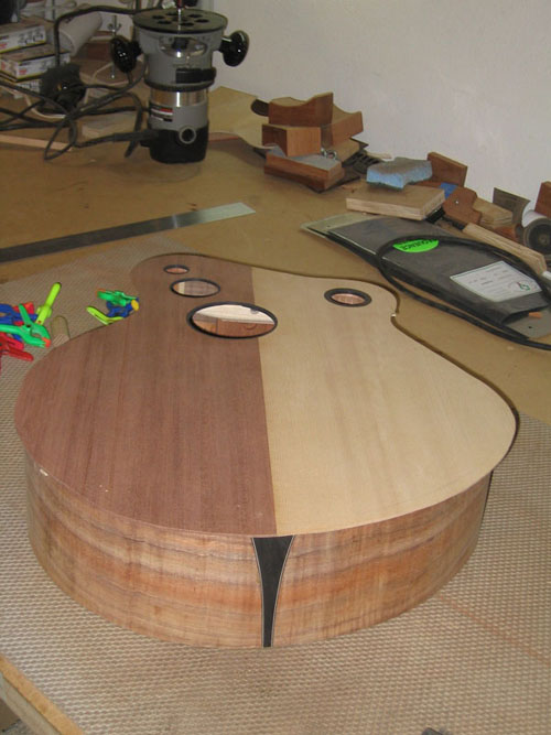

Now a purfling question. I'm thinking of using rope purfling with a single black border on the outside. Binding will be ebony with maple side purfling. I know LMI sells rope binding, any other sources? Here's a shot of the guitar it's going on. Any other suggestions?

I love the contrasting top. What is that Redwood/Sitka?

Jimmy cool jig. That said,I have to object. I am highly disappointed at the guitar. It is not made right. There is not a proper soundhole and therefore can't work. The two different tops won't work either. The end wedge well all of the guitar just isn't what it is supposed to look right, and therefore not playable. To make guitars that will be playable, you can't do it this way. I suggest going back to the drawing board, buy some wood and do it right. When you have, then you can post pics and say you built a guitar. Please don't insult the playing community with this kind of stuff guys, there is one way and look for a guitar to be right and this ain't it. Right Lance? How come you didn't edit the photo's? This just can't be!!

You're right Stan. Maybe I can make a planter out of it.

So how does this work? does your dremel base reference first on one side, then on the other to cut the outer most channels then you rout out the stuff between the channels?

I use my StewMac base and just place the base inside the curved guides on each side. Since it's an outside curve the base just slides along the guides. I route each side, then the middle. It's idiot-proof (well, so far, anyway). It's designed for the base to sit sideways in the jig. That is the v in the jig points to the side, not the top or bottom, although you could build it the other way. The opening would be wider to accommodate the wider dimension of the base. If this doesn't make sense, I'll send you a picture with the Dremel in the jig.

I made a template from plywood and double stick tape it to my blank, then to the router table.

It's redwood/sitka. Redwood from Dave Maize. Sitka I bought in 1983 from Lane Moller. It's got some nice bearclaw, but it doesn't show up in the photo.
