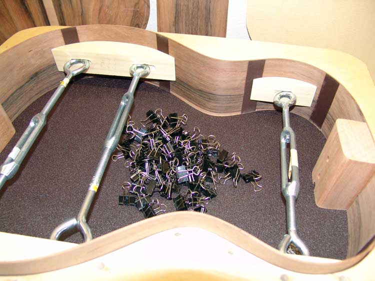

I use Gem Clips which fit reversed kerfed linings very well and they are cheap too.

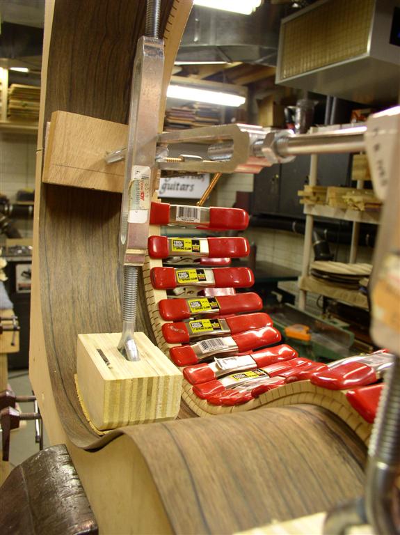

I like these plastic spring clamps. The only problem is you'll find a few of them very strong and some weak. But, most are A-ok.

Welcome, Aasmund, to the OLF. I haven't done it yet, but I bought a bunch of Gem Clips, like Hesh, and lined them with self stick cork bought at a craft shop.  1 piece lined about 40 clips.  I also have some old clothes pins that I could use in tight places, since they aren't as wide as the clips.

Heath, that is what I use. They work great. I use a double thick lining when gluing, this keeps the liner that is glued in unmared.
I have had the gem clips stain basswood linings, and also crush them.

[QUOTE=DaveAndy] I like these plastic spring clamps. The only problem is you'll find a few of them very strong and some weak. But, most are A-ok.
I've used this style, too, for about 8 years with great success. The nice thing is that the "feet" pivot so they apply an even pressure to the angle of the lining while staying flat against the outside of the guitar rim. And they will work on any style lining because of those pivoting feet.
The comment about the occassional "weak" clamp is correct. However, since you can often find them in bulk at a tool supply store you can hand pick them and test squeeze as you go to get a fairly consistent set. However, I have found the even the "less taught" units will still hold the lining against the straighter areas of the side bends with adequate force. I have about a 150 of them and can do the entire edge of 2 instruments at a time. If you plan on one-at-a-time then you'll need 60-75 of them.

[QUOTE=Hank Mauel] [QUOTE=DaveAndy] I like these plastic spring clamps. The only problem is you'll find a few of them very strong and some weak. But, most are A-ok.
This is the way Im going, Ive got the bigger ones for more pressure, and smaller ones for in between.
With the clothespins you could cut them to match better on a bandsaw, and increase their strength by adding a wood ship to the outside, as said, at Walmart for $4.00 bag of 50. But these adjust to the angle, these are my choice.

One thing I will warn you about on the plastic spring clamps, and it has little to do with "IF" they get the job done. And that is that they fatigue quite easy and will break just past the spring at the clamp end. I know this because I have used the ones Wal*mart sells, The ones Harbor Freight sells, the ones Sears sells and Ace Hardware sells. They all seem to have this same more than occasional flaw. It is a weak spot where the springs arm leverages against the clamps jaw. Sooner or later they let go and fatigue the plastic. Now I have many of these that have lasted years. but better than 50% have broken on me. The higher the spring tension or the accidentally letting them snap close, the more frequent the failure. Now I have had my set of 1" (wide) steel spring clamps for 5 years now. Not one has failed and i never expect them to.
Also don't fool your self into thinking the pivot foot gives consistent clamping pressure across the whole foot. They don't The clamping force is much stronger at the point of the pivot and is very light at the inside edge of the foot the steper the angle. This is not a huge deal but if you use triangular linings you will want to be aware of where you are applying the force as it is easy with the plastic pivoting feet to get all the force on the bottom of the lining and very little actually near the top of the rim.
I know it sounds like I am viciously bashing the plastic spring clamps. I really am not. They are OK and will get the job done. Plus they are relatively cheap. But for my money the failure rate and inherent issues with the plastic fatiguing diminish their value when compared with quality steel spring clamps or even better the Watkins clamps fitted for the type of lining you use. To me you get the quality you pay for. Now for each of us there is a point of diminishing value, that is why I personally did not buy Watkins clamps. However I plan on doing this the majority of the rest of my life, so a tool that will last as long as I do is important to me. But I started with close pins with rubber bands then the plastic spring clamps. So I do understand starting cheaply but the longer you do this the more important quality tools will become. Just set back and watch.
