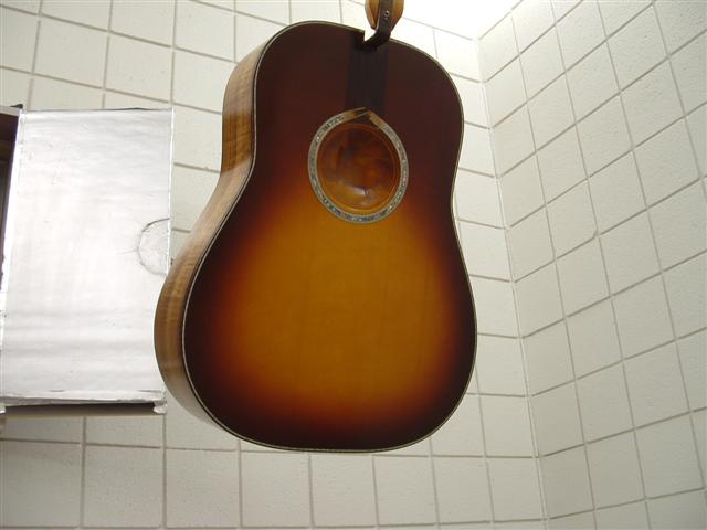

Tonys wife sent me a few updated images of the 12fretter!

The idea was to match the colors of the snakewood bindings at the edge and lighten from there.
The Purfling is Walker inspired flamed maple custom made by the zootman, the rosette is cut from a flamed maple blank then inlaid with Redheart with an inner and outer b/w/b ring.
The neck is mahogany, ebony board with a MOP vine inlay, Gold Waverly's with snake wood buttons, and a black on black Ameritage case with my logo embroidered on the out side
Next picks maybe it'll have strings

Certainly will be a stunner!
Lance, can you find out for me what kind of tape he used to mask off that rosette? Doing a sunburst with a rosette like that always presents that problem!

Everytime I see picts of Tonys spray booth it seems bigger and bigger.
At first I thought it was a shower stall with white tiles...then I saw a
door...now I see guitars 100 yards back still in the booth
What a setup

Lance that looks fantastic. Beautiful work as usual and Tony's workmanship is icing on the cake.
Mark I use 1/8" masking tape from 3M It takes a bit of time but works pretty good. Maybe Tony uses something else.

Lance, that's really tastefully done! I like that you can still see the wood grain through the color. Good choice!

It's a nice finish, but honestly, I'd prefer that guitar with a plain, slightly amber tinted top. For the record, like.

BTW, great looking guitar Lance. I think I prefer a burst with a plainer back/side combo though. Maybe mahogany stained dark. From the examples I've seen on this forum, Tony does do amazing work.
