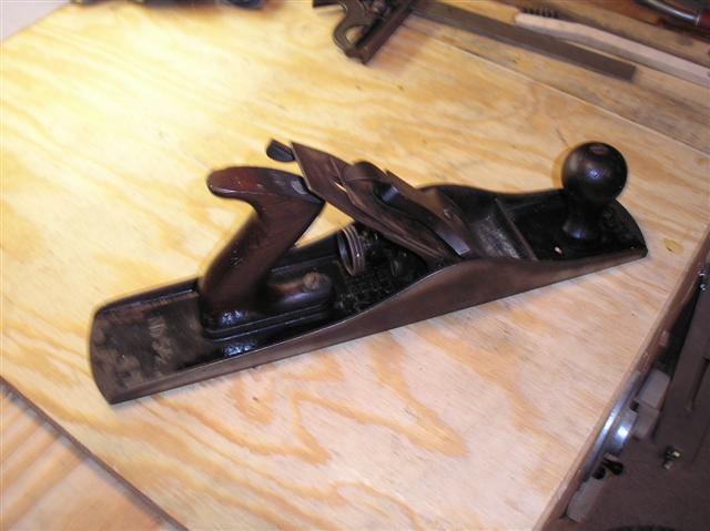

My Stanley/Baily 5 1/2 bought at the flea market. It does the job very nicely.
PostPosted: Mon May 15, 2006 10:30 am
Posts: 338
I use a #6 stanley, I guess really a "jack plane" but at 18" it is a bit lighter then the "7 and does a great job. I got it off E-bay for about $30. An hour of tuning and it makes a great shaving, .0015" thick. Even the original blade was fine once I worked it, but I did replace it with a Hock.   If you get one of e-bay, just remember to get a plane without the original decals and the perfect box, those cost hundreds, the users are common. Stay out of a bidding war and you can get a great plane cheap.   I got a #4 for $25 that is in great condition also. Both of mine are 95+% japaning and no cracks in the totes..
