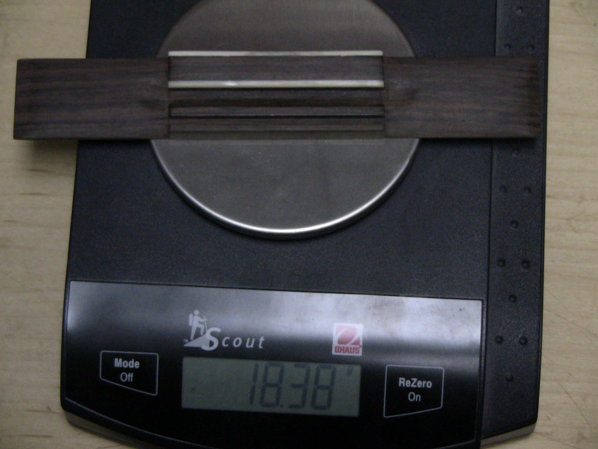

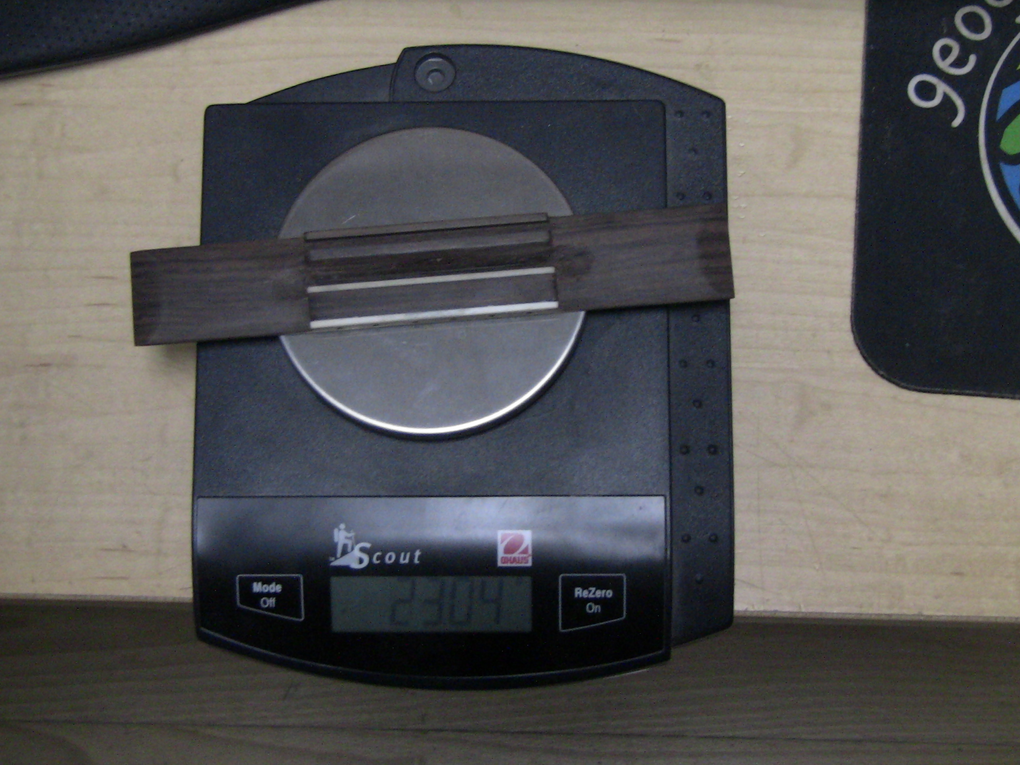

If I may, I'd like to piggyback on this question with some more classical bridge questions of my own.
If using BRW for a classical bridge, what weight should I aim for (in grams)? And is this measured with the bone strips in place on the tie block or not? With the saddle or without?
I'm nearly done making the bridge for my first classical guitar (yeah, it's taken way longer than I thought it would to make!). It just needs tidying up and sanding a little more, then shaping to the guitar body. It's BRW with cow bone tie block strips. Right now it weighs 23.04g and has nice tap tone (like a marimba bar!).
Is this about in the right ballpark? Should I try to shave some more off (from areas where strength isn't a big issue?)?
All input welcome.
Dave F.

PostPosted: Thu Dec 31, 2009 12:13 am
Joined: Tue Apr 22, 2008 4:24 pm
Posts: 148
Hi Dave
The weight includes anything you add to it, as is this case with the decorating bone strips.
Standard bridge weight for a classical is between 18 and 25 grams. With lattice and double top designs, some luthiers bring it down to 13-14 grams.
The weight of the bridge must be considered in relation to the overall design of your guitar. A heavier bridge will in theory improve sustain, but may have a negative impact on volume. A lighter bridge will in theory allow more volume, but decrease sustain. Again, this is all in relation to how you built your guitar, and there are dozens of factors to be considered.
My recommendation is to go for a compromise at first. 20 to 22 grams is a fairly safe way to go. I have learned that it's better to start an experiment at the middle of the road, then slowly stretch the envelop rather than the other way around. If you sand you bridge a little more and it comes down to 21 or 22 grams, you should be OK.
My 2 cents.
Pat

Dave, it will end up down to 22 with some clean-up and it will probably be just fine since it is the middle of the interval more or less. You could round the saddle block ridges more, and try to flatten the tieblock more with a file. Also file the slopes of the wings (not the top) near the bevel to bring the bevel shape closer to a real, bigger circle. You can also file a rounded trench at the exit string holes. This will save some weight and relieve some of the tension off the back seam.

Thanks for the tips Pat/Alexandru - most helpful!!

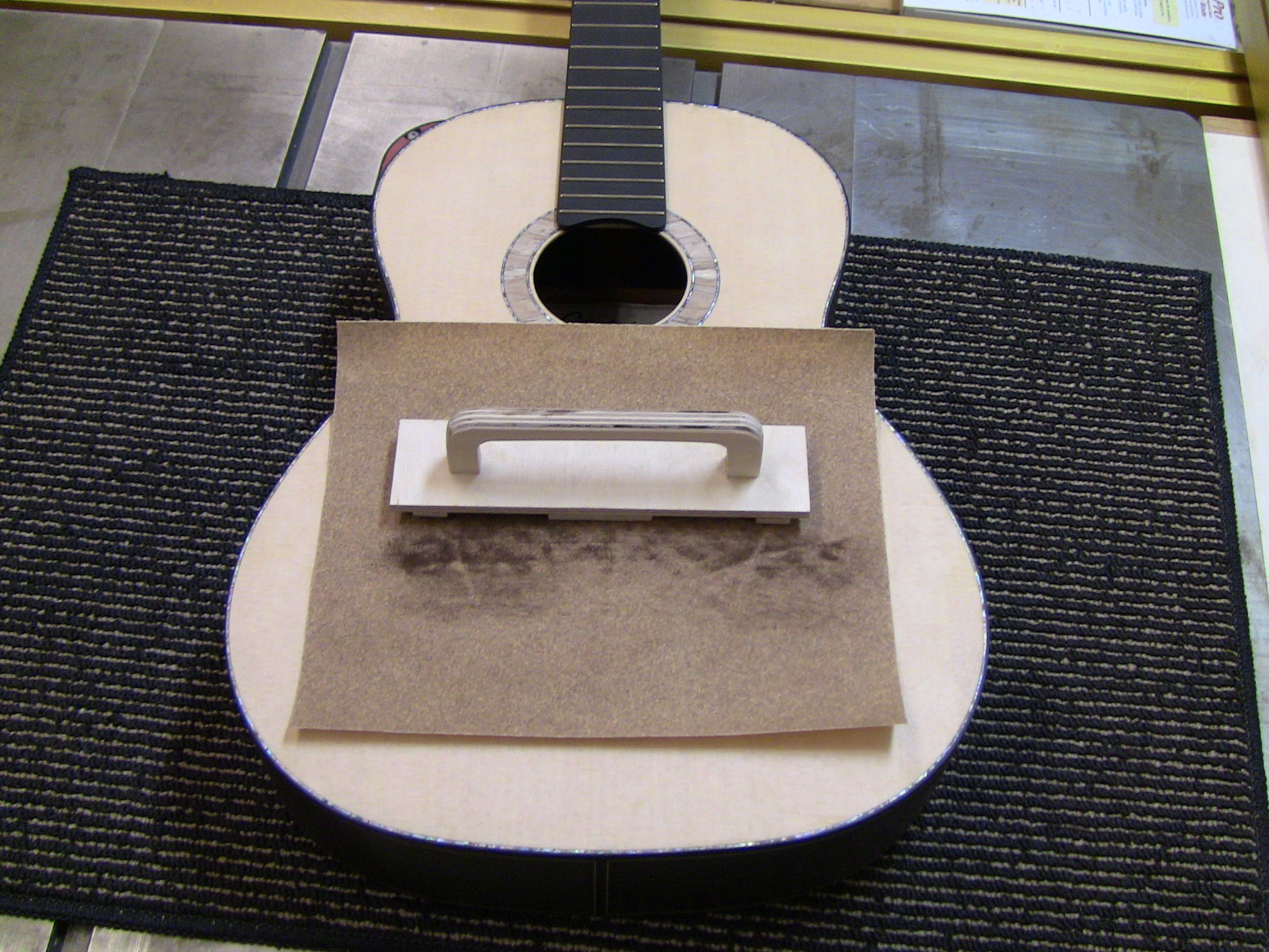

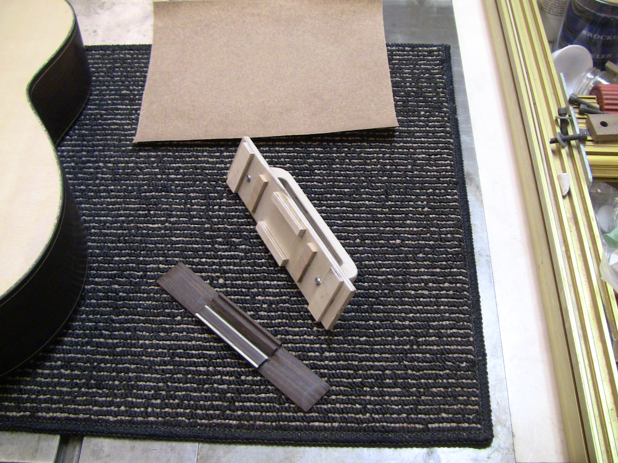

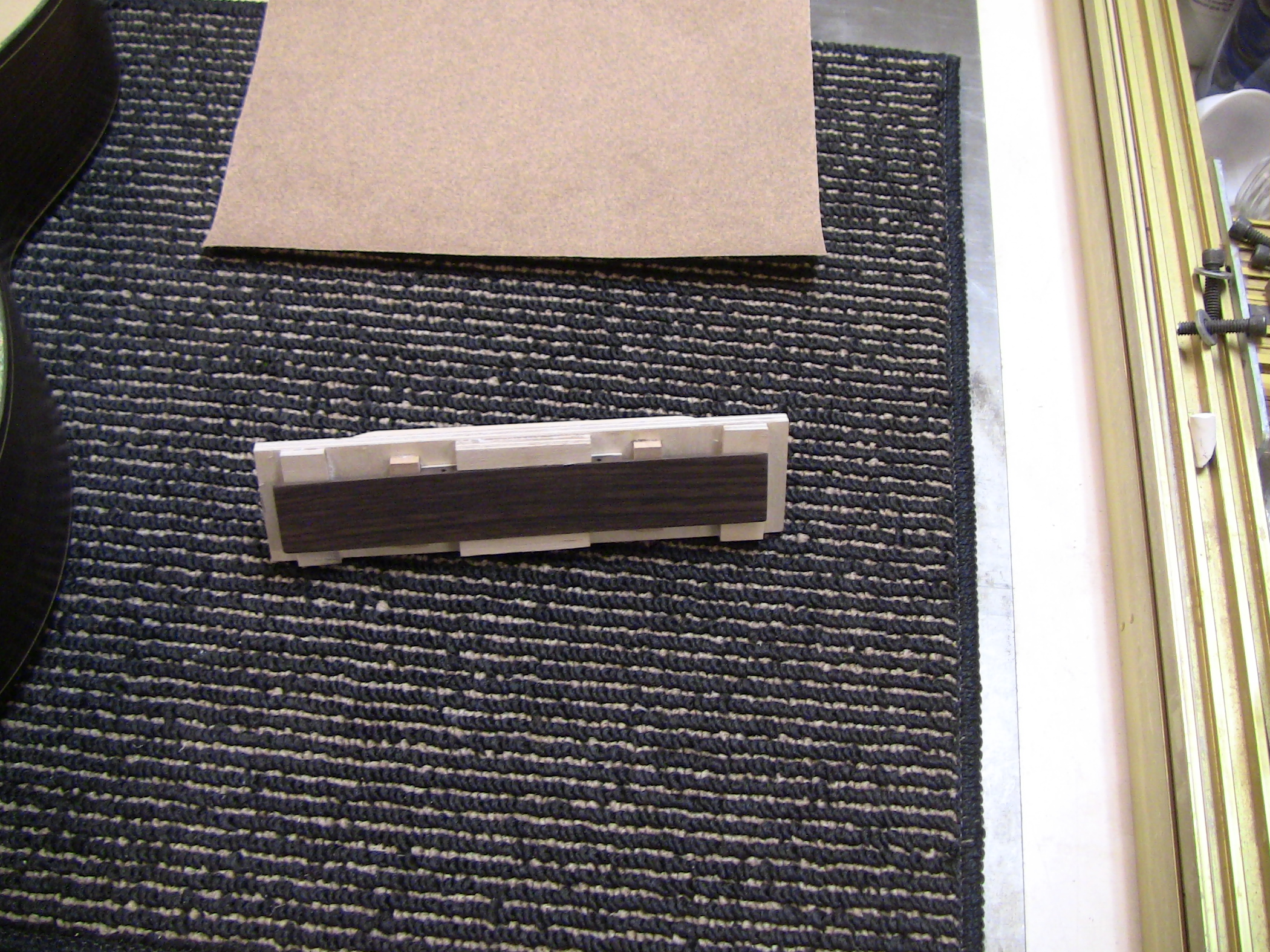

I spent some time earlier today fitting the bridge to the guitar body. I had to take quite a bit of material off. It was hard holding onto the bridge while trying to apply even pressure to the sandpaper on top of the guitar, so I made a small holding tool. I had to finesse the block sizes on it so that the sanding pressure would be even across the whole bridge, but it didn't take long to make. With this tool, the bridge shaping went much quicker and smoother. Here are a few pictures of the bridge sanding holder (click them to see the hi-res versions):
After clean up and finish sanding, the bridge now weighs 18.38g and is a perfect fit on the soundboard. I'm happy with that.
Now on to finishing this guitar!
